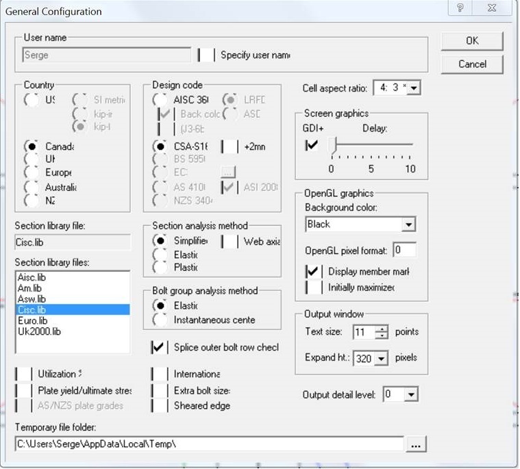

The dialog boxes are jumbled up
 Product(s):Limcon
 Version(s):V8i
 Environment: N/A
 Area: Modeling
 Original Author:Payel Sasmal, Bentley Technical Support Group
Problem Description
I am running LIMCON in a new computer; why are the dialog boxes look jumbled up?
Go to Control Panel\All Control Panel Items\Display\Screen Resolution; OR it could be \Control Panel\Appearance and Personalization\Display
check the setting "Make text and other items larger and smaller", keep it as default at smaller or medium. If you select Larger, or more, the dialog boxes will appear jumbled up.
