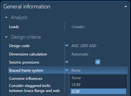

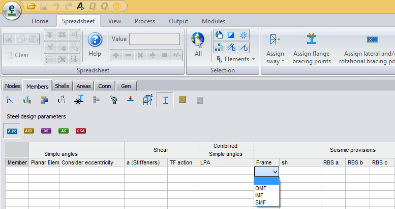

Frame Types for Braced Frames used in the Connection Module are not available.
Only moment frame types are included for frame type selection in the main program (input under Spreadsheet - Members - Steel Design - AISC - Seismic Provisions - Frame:
Specific braced frame types, OCBF or SCBF, can be assigned in the Connection Pad, but these are not saved with the connection joint and has to be reset each time the connection is reviewed.
Previously recorded as TR 70797
Assign the frame type within the connection pad and then print results.
