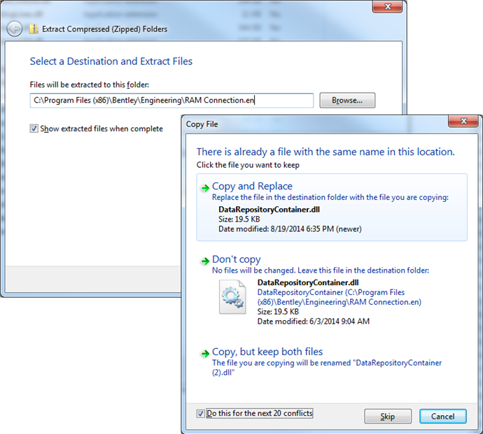

4. Extract the files using to the following directories,
File NameLinkFolder *Language
Users_RC_Eng.zipUsers_RC_EngC:\Program Files (x86)\Bentley\Engineering\RAM Connection.enEnglish
Users_RC_Spn.zip * pending *C:\Program Files (x86)\Bentley\Engineering\RAM Connection.esSpanish

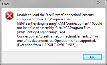

IMPORTANT - use only 7-zip to extract these files, not Windows or WinZip. If 7-zip is not an option, then contact support with a service request. Otherwise the extracted files may have an altered time stamp and the upgrade will fail, giving an error like this:
Details about this unzipping time stamp problem here
These are the default or typical paths for an English language operating system. For other language OS, or when the install path was changed from "Typical", the folder should match the path to the file RAMConnection.exe. On x32 bit machines eliminate the (x86) from the folder path.

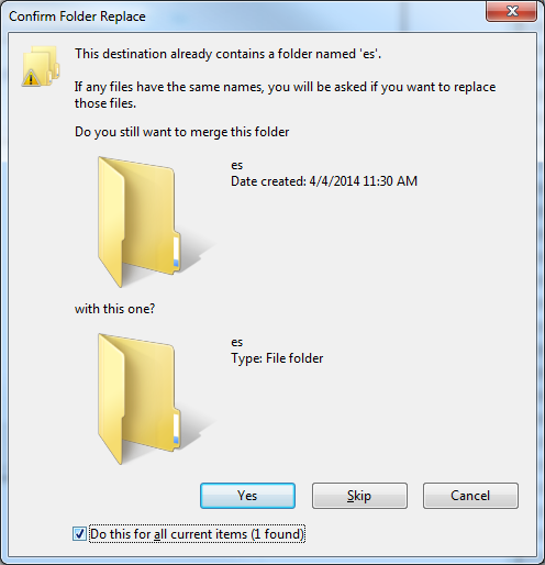

Overwrite existing copies in all cases:
Also merge the contents of any subfolders:

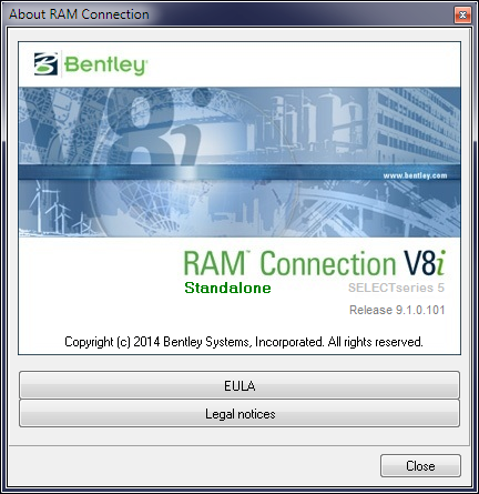

5. Confirm success by checking Help (?) - About for the updated release 9.1.0.101:
