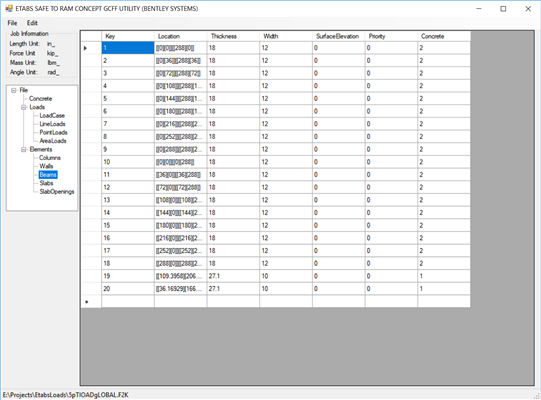

This Updated Utility can import .f2k files and export .gcff files which can be imported into Ram Concept using File - Sync Staad - New from STAAD GCFF File.... This Supersedes the Excel Macro tool RAM Concept Tabular Input (ETABS Link)
To install download and unzip following link:
https://bentleysystems.service-now.com/community?id=community_document&sys_id=313f73921b314610dc6db99f034bcb7c
The Run the extracted file application, RamConceptSAFEISM.exe.
Users are advised to use this updated Utility in place of the previous EXCEL Macro tool. This tool can handle large F2k files many orders of magnitude faster than its predecessor. The tool also removes the need to have the F2k property names to be void of spaces and consists of alphanumeric characters only.
