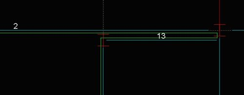

One possible cause for such an error is the presence of zero-length beams or walls in the model. These members cannot be seen, but the numbers can be displayed. If you see beam numbers with no associated beams or overlapping beam numbers, this will help in locating the problem. You can then delete these beams with a fence. The beam numbers should then disappear as confirmation.
Under normal circumstances, zero-length beams cannot be modeled, but they can be imported from DXF or Revit, or they can sometimes result from modifications to the grids after the beams have been modeled.

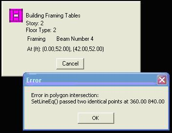

When any design module is initiated, the program starts by “Building the Framing Tables”. During the process, the program goes through the beam loops one at a time to determine the tributary loads. If a polygon error occurs while the framing tables are being built, the user can identify the beam number and coordinates together with the floor type where the program stopped processing information. This information can be helpful in locating the source of the error.
The polygon error may be followed by a second error message saying, “SetLineEq() passed two identical points at 0.00 0.00”.

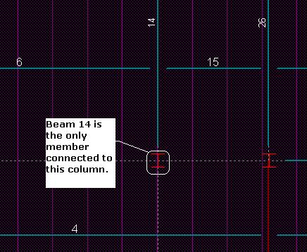

This usually indicates a problem with the shape of the beam loop. For example, if there is only one beam connected to an interior column within the deck area, a polygon error will arise for one of the members in that immediate vicinity:

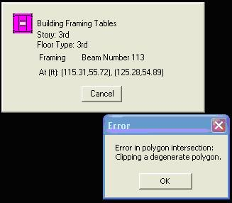

A second type of message saying, “Clipping a degenerate polygon” or “Too many intersection points” indicates a different type of polygon error.
The error in this case may be due to internal numerical accuracy, especially when the beams or polygons in that area are ever so slightly skewed in plan.
This type of error is often caused from having multiple, overlapping surface loads or decks. The program only counts the top-most layer of surface loads when analyzing a structure, but it must make a determination about what load is "on top" by comparing the areas of the various overlapping surface load polygons as they were applied. When multiple layers of loading are used, this calculation becomes more complex.
The program may give an error when only a tiny sliver of one load overlaps another, or if the edge of a surface load polygon is very slightly off of a beam line. In this case, it is necessary to delete and re-apply that surface load in a different area. The more complicated the beam loops, the more likely a polygon error will occur.

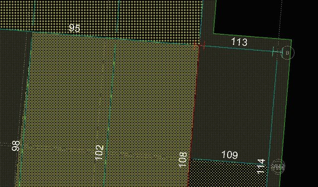

In the example below, the end coordinates of beam 113 did not match the end of beam 108 or the column in that location creating a tiny polygon for the program to deal with. Furthermore, the surface load also angles just slightly away from beam 98.
To solve the problem in this case, beam 113 was adjusted to match the column coordinates and the surface loads were recreated.

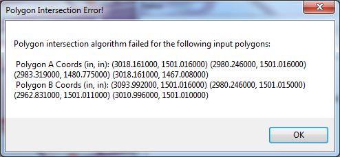

RAM Concrete – Meshing Diaphragm

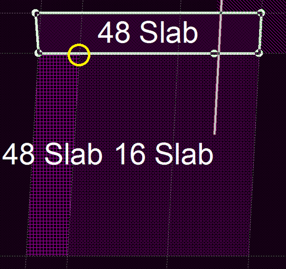

Below is a polygon intersection that was produced when the diaphragms are meshed during the RAM Concrete Analysis. This error is associated with adjacent deck polygons with edges that are slightly skewed relative to each other. This slight skew results in a small area of several overlapping polygons. The problem floor level is identified in the Analysis Status window. The coordinates, defined in inches, are noted in the error message. This information is useful in locating the offending polygons.
In the example below, the "48 Slab" and "16 Slab" deck areas snap to a deck vertex at the point marked in the screen capture. However, the top "48 Slab" area does not have a vertex at this point. Because the 3 nodes at the bottom edge of this polygon have slightly different y-coordinates, there is a slight skew and small overlapping zone near this area. Adding a deck vertex in the polygon representing the top "48 Slab" area at the point marked in the screen capture resolves the problem.
