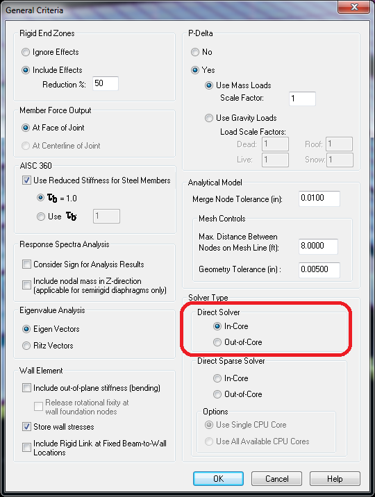

RAM Frame In-Core Direct Solver
Problem:  Analysis time with the In-Core Direct Solver (selected in RAM Frame - Criteria - General, see figure below) is significantly slower in v14.06 than in earlier versions.
Work Around:  Analyze using the In-Core Direct Sparse Solver.
Resolution:  This issue was resolved in v14.06.01.
