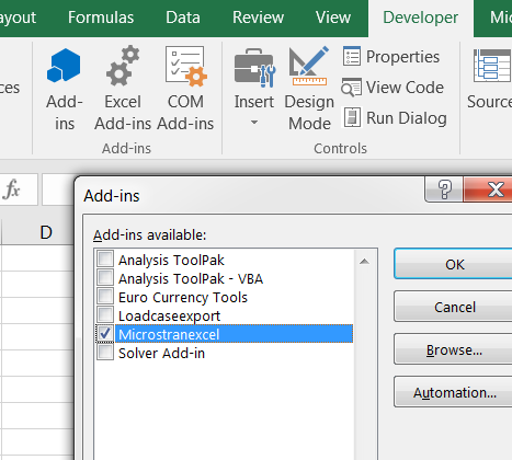

Once extracted, place the *.xlam file in “C:\Users\[USER NAME]\AppData\Roaming\Microsoft\AddIns”.
Then open Excel, Developer, Excel Add-ins and select Microstranexcel per below screenshot

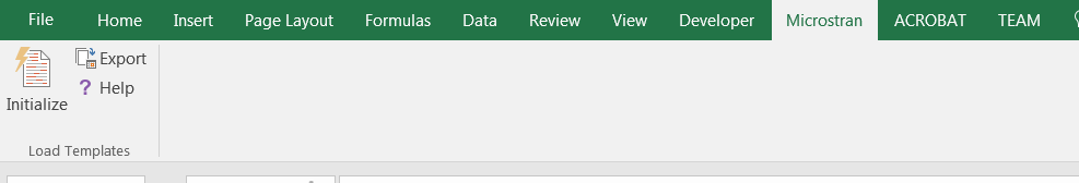

Once installed, the Ribbon in MS Excel should like the below in any workbook.
2. Using the Addin
Clicking the "Initialize" button will add the following sheets in your (existing or new)  workbook. (Note that initialize is a safe action, it ensures your workbook has the correct data sheet to proceed). Do not rename any of the added spreadsheets below

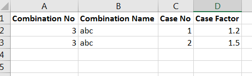

  Microstran_LoadComb
Column "A" Combination No needs to follow on from the last Case No as defined in sheet "Microstran_LoadCase".

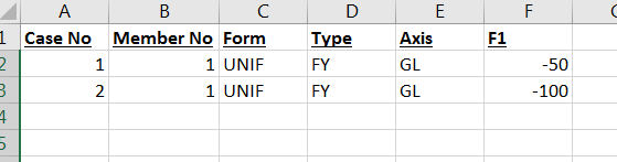

  Microstran_LoadMember
This sheet defines the loads that correspond to a particular primary load case. Currently it only supports UDL on members. To have loads come through the export, Member No must match that as defined in Microstran.
Case NoRefers to the load case number
Member NoUnique Member No that corresponds to that in Microstran
FormKeep this as UNIF, only supported load type for the time being
TypeFY,FX,FZ,MX,MY or MZ
AxisEither GL for Global or LO for Local
F1Load Value

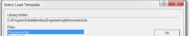

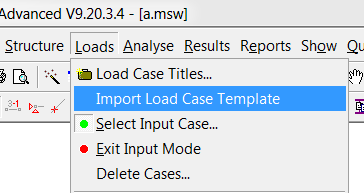

In your Microstran model, go to Loads, Import Load Case Template
The designated Load Case Template file is entitled "Fromexcel.ltp"

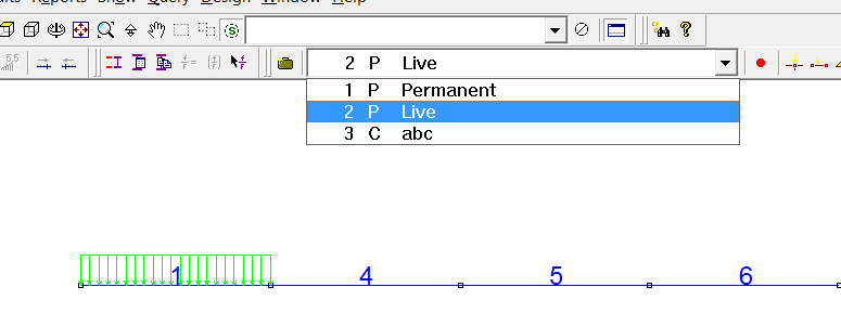

After completing the above, and (assuming the corresponding member number exist in both the data sheet and Microstran model) you should get an similar to below:
The example above is trivial, but can be very powerful time saver for instances where you have many member loads, load cases and load combinations defined in Excel.
