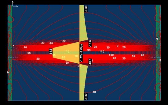

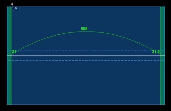

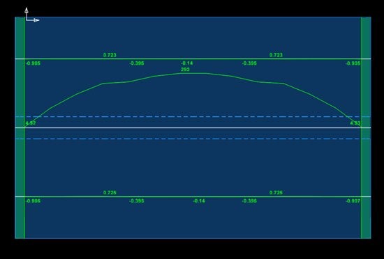

At a centroid step, in the real structure, and in the true elastic analysis performed by Concept, bending moments in the floor system will cause axial forces in the floor. This behavior is easy to understand in the simple example of a T-beam resisting a positive bending moment; the flanges of the beam will be in compression and the web will be in tension even though there is no net axial force in the beam. The figure below shows a T-beam with plots of axial force (see Figure 1). In this example, the total bending moment in the slab is divided into two parts: half of the bending moment is resisted by local bending (see Figure 2) and the other half is resisted by the force couple due to tension in the web and compression in the flanges (see Figure 3).
 Figure 1. Axial Force Distribution in a T-beam and Adjacent Slab
Figure 2. Moment Plot for Design Strip Including T-beam and Adjacent Slab
Figure 3. Moment Plots for Design Strips Including T-Beam Only and Adjacent Slabs Only

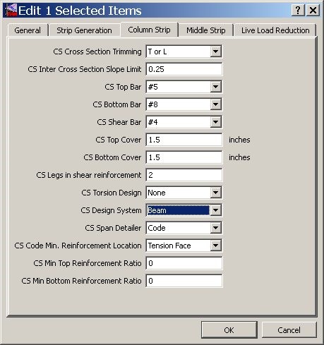

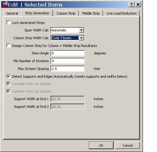

T, L, Z and U beams are generally analyzed and designed as single units, with a unit stiffness and unit capacity to resist structural forces. This approach is also appropriate in Concept. We recommend that design strips be generated with column strips matching the effective flange width of the beam (see Figure 6). This is done by selecting "Code T-Beam" for Column Strip Width Calc in the Strip Generation tab of the Design Strip Properties Dialog (see Figure 3). In the Column Strip Tab, "Beam" should be selected for CS Design System (see Figure 4). This will ensure that the concrete code rules for beams will be used in the design of the strip. The forces in the middle strips will normally be small and will only require small amounts of reinforcement.

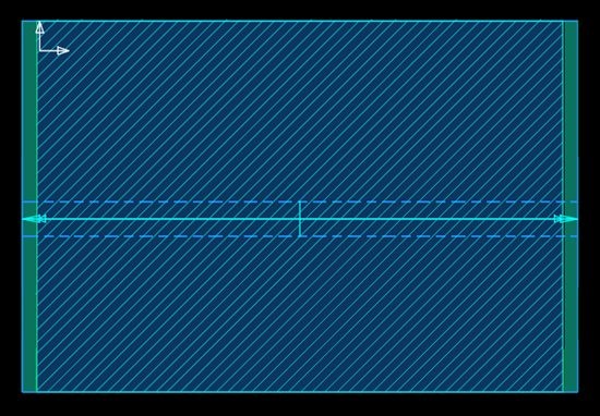

To illustrate the effects of design section widths and Concept's ability to include axial forces in design, a simple T-beam was designed as a unit and as separate web and flanges. Designs were performed with net axial forces both included an excluded.  See Table 1 for s summary of the analysis results.

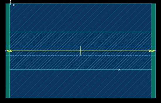

For the "T-Beam As Unit" design, a single design strip, including the beam and the slab, was defined (see Figure 7).
Figure 7. Design Strip for "T-Beam As Unit" Design

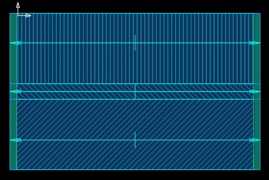

For the "Web Only" and "Flange Only" designs, three design strips were used (we do not recommend that you draw your design sections like this). One design strip just crossed the web, and the other two just crossed the flange on either side of the web (see Figure 8). The "Flange Only" results below are the sum of both the flange design strips.
 Figure 8. Design Strip for "Web Only" and "Flange Only" Designs
