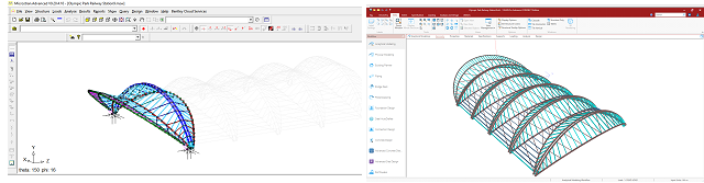

Microstran now have direct export capability to STAAD.Pro allowing users to leverage many more advanced features in STAAD.Pro.
Improved Interoperability
Bring your microstran design into another application or even to site, using ISM and iModel Publishing.

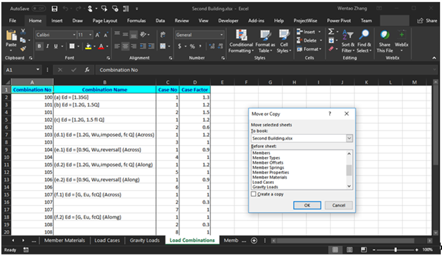

Import and Export Models to Microsoft Excel
Microstran now have the ability to allow users to modify any aspect of the model in a tabular manner via import/export to Microsoft Excel Spreadsheet.

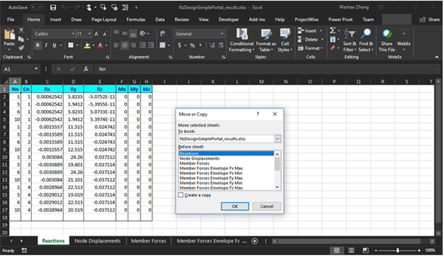

Export Analysis Results to Microsoft Excel
In previous versions of Microstran, results were only accesible on screen or text files. Now, Microstran can have all results exported to one Microfot Excel Spreadsheet, each sheet withing the Spreadsheet holds 1 table of the results.

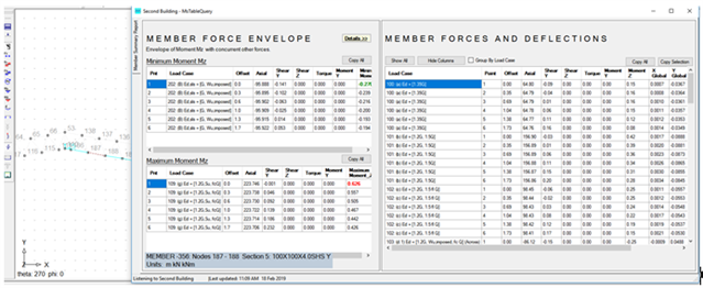

Member Summary Query
In previous versions of Microstran, queried results (Member Forces, Member Deflections Enveloped results) were only viewable on screen, it was not possible to copy these results for further processing. With Microstran CE, users can now select members on screen and have these results displayed in tables for viewing sorting, and copy to Excel.

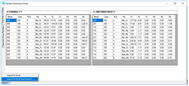

Section Summary Viewer
Analysis Results grouped by section can now be quickly viewed in Section Summary Viewer on screen and also Exported to Excel.

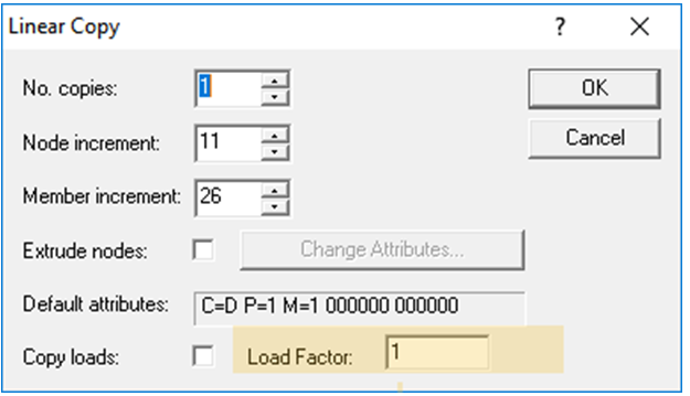

Linear Copy (Optional Load Factor input).
An optional load factor box in Linear Copy is included in Microstran CE, this applies a load factor to all the loads being copied. This helps users that create 3D portal frame models from a 2D frame, where loads are progressively reduced (or increased) from one frame to the next (manual application of wind loads).
