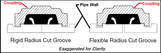

Most grooved coupling come in two types, rigid and flexible. The rigid coupling rigidly connects components / pipe together, while the flexible coupling allows both axial and angular movements within limits

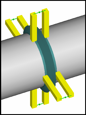

Model Flexible Coupling
The bases of these modeling approaches was presented in a published article; "Flexible Coupling: modeling of bi-linear moment rotation relationships in AutoPIPE"  by Nasir Zulfiqar (see attachment, Flexible Coupling_Nasir Zulfiqar.pdf)
The flexible coupling model is more complicated and involves modeling axial and angular flexibility.  The use of a flexible joint element is recommended. The shear stiffness's of the joint can be set to rigid and the torsion and bending stiffness's estimated.  The axial and bending flexibility is modeled using 4 rigid spider beams on each end of the flexible joint and these are connected using 4 tie-link supports with gaps.  This model is similar to flexible joints model with tie rods.
The determination of the stiffness and gap settings for the 4 tie-link supports is somewhat involved and is explained a little better in the articles mentioned on this WIKI page:
a. Flexible Coupling_Nasir Zulfiqar.pdf
b. Modeling Victaulic Flexible coupling Method-2_Rev 01.pdf
Note:
1. Modeling every flexible coupling in a model (say 10 or more flexible couplings) could be a cause of nonlinear convergence issues.
2.  Check Beam properties, some values cannot be extremely large: (ex. setting modulus as 1e8 in a field that has units of e6, stored value would become 1e14). Setting the modulus value for the rigid to a more reasonable value (say 1000 times steel modulus = 200 E6 N/mm2) resolves the problem
Method #1: Model Flexible coupling using  Tie-links, rigid frame members and a Flexible Joint
The 1st method has the following attributes:
Bentley visited Victaulic in 1998 and gave a presentation on the use of AutoPIPE to model Victaulic couplings. The AutoPIPE model for a Victaulic coupling is based on using tie-links, rigid frame members and a flexible joint.
The orientation of the frame members and tie-links can be in any direction including relative to the local pipe cords and resulting model gives a bi-linear spring rate action where the gaps on the tie-links can be set to simulate a limit on angular rotation before the spring rate of the tie-link becomes active.
Discussions with the Victaulic people felt this modeling approach reasonable but the only problem was the lack of bending stiffness data available at that time for Victaulic joints. Bentley cannot provide the exact stiffness values to be used, recommend contacting Victaulic Engineering Manager. Since Victaulic does not publish stiffness data in their literature, the CAE development team approximated all the values used when developing the modeling approach.
Basic type of construction:
1. Insert a flexible joint with information gathered from Victaulic's catalog / personnel.
2. On each side of the flexible joint insert 4 rigid beam members (Up, Down, Left, & Right)
3. Connect the far ends of coinciding beam member together with a tie-link support.
