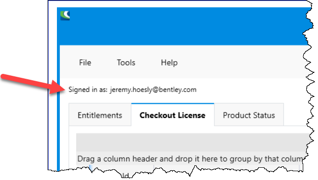

5. Open BLT (Bentley Licensing Tool) and confirm that your email address is below File,
Example:
Can you see your email address in BLT?
If no, please send screen shot and stop here, do not proceed below.
If yes, please continue below.
