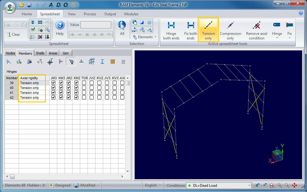

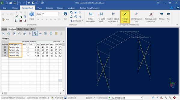

How can I assign a member to be tension-only?
In the Spreadsheet, go to Members - Axial behavior and for any tension only braces select Axial rigidity = "Tension only" or use the Ribbon menu tool "Tension only" once you have only the desired members selected.
Normal, linear biaxial behavior is "Full".
"Compression only" or "Cable" options are also available.
In prior versions this was included on the Member - Hinges spreadsheet. The first field was for "Axial rigidity".

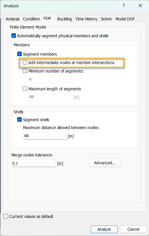

  3. If the tension-only member intersects other members and the Finite Element analysis option to "Add intermediate nodes at member intersections" is checked, then there will be intermediate points of connection (without hinges) leading to force transfer and potentially bending.

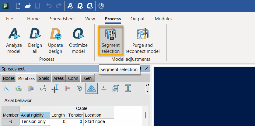

We suggest not using this option for models with tension-only braces. If there are other places where you really want joints at member intersections, manually segment those portions using Process - Segment selection.

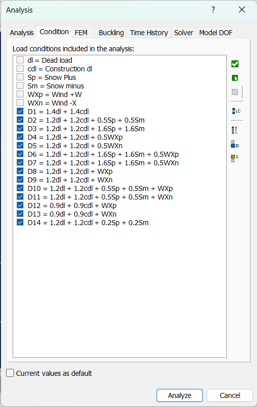

When you run a P-Delta analysis, or a tension-only analysis, or compression-only analysis, each combination is solved directly. We do not use addition, or superposition, to calculate combined effects since a member that might not be in compression due to one load may be in compression due to that same load combined with another.
Under Process - Analysis - Condition tab the user can select which cases or combinations to include.
