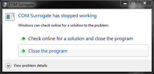

An improper argument error (see below) occurs when generating floor framing DXF files in RAM Manager. After bypassing the error, a DXF file is created but it cannot be opened.
A program crash occurs when attempting to generate DXF for columns and footings.
Some users have reported this issue when the DXF is saved on a network drive.
Save the file to a local drive. The file can be moved to a network drive after the file is generated.
