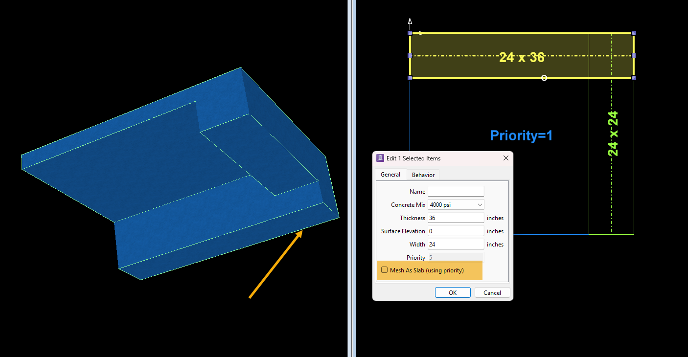

Why is it necessary to have priorities?
Without the priority system the modeling of floors would require one of two methods:
  1. Objects for slabs of different thicknesses, beams, openings etc. could not overlap - this would be very tiresome for all but very simple floors.
  2. Depths would have to be additive. For example, you would have to deduct slab depth from beam depth. If you had to change the slab depth then a change would be required for the beam, unless its depth changed by the same amount.
For beams, RAM Concept does offer an alternative to the priority system. When not using the priority system, the program considers the thicker beam where multiple beams intersect.

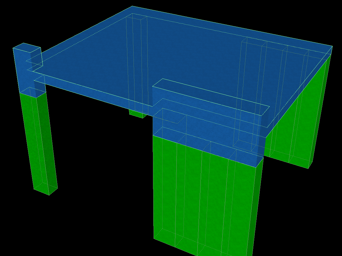

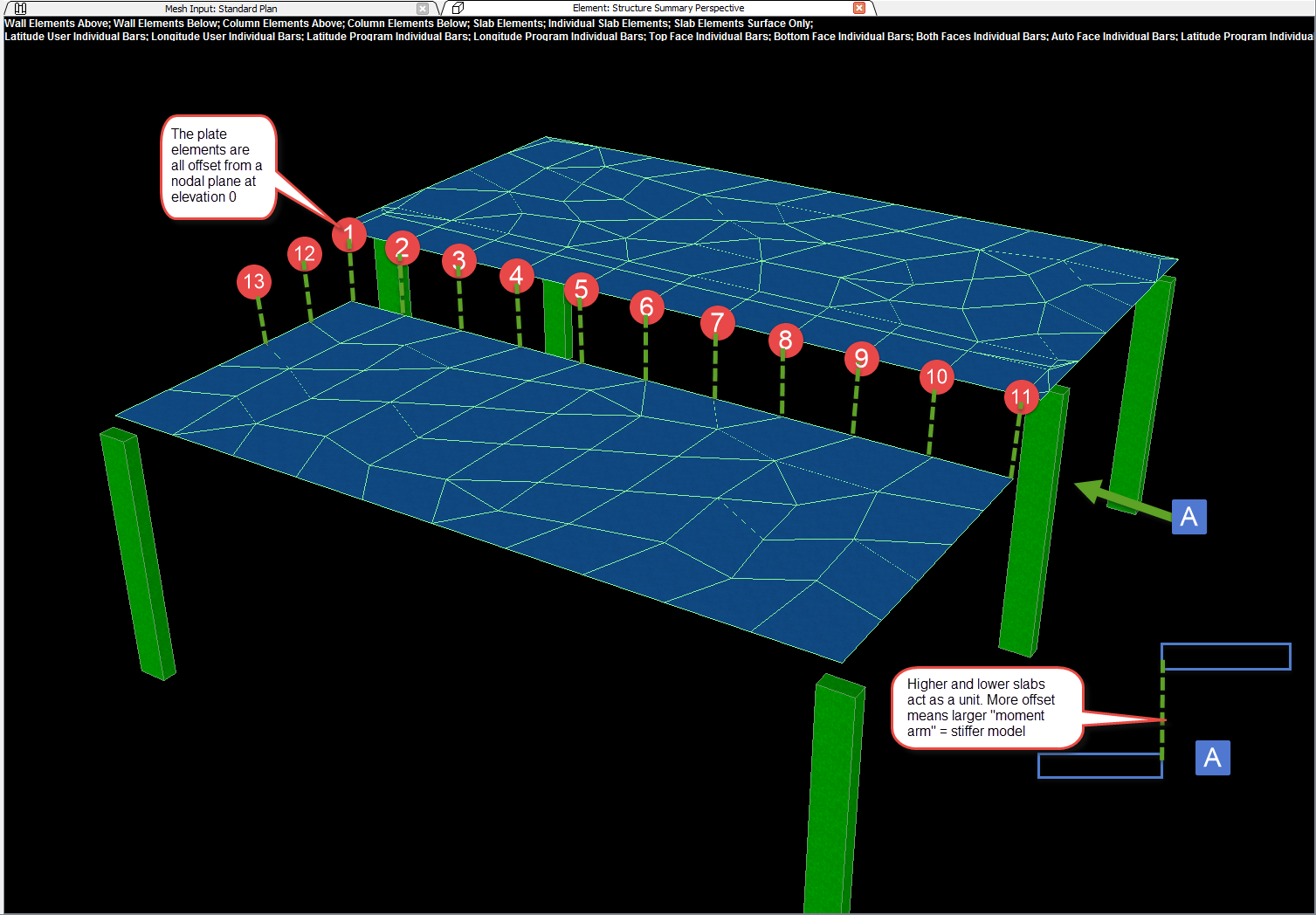

Can Adjacent Slab Areas be Modeled with a Vertical Gap Between Them?
Slabs that are continuous in plan will have continuity in structural behavior in the model, regardless of the elevations/thicknesses of the slab(s). This continuity occurs even if the slabs are at different elevations and are actually disconnected. The image below summarizes the behavior assumed in RAM Concept.
It is possible to model discontinuous slabs in the same model, but it requires a physical “gap” in plan to create this discontinuity. We recommend modeling any such gap at least 3" wide, as smaller separations can be eliminated during meshing. Another option is to use two separate RAM Concept models to analyze each floor.

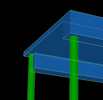

What is the difference between beam and slab elements?
There is no difference unless you modify their behavior. Refer to the RAM Concept Manual Chapter 18 "Defining the Structure" for more information. The main difference between beam and slabs is how they are modeled: a beam is modeled by clicking on two end points along its centerline and always has two parallel edges offset from centerline, while a slab area is closed polygon and can be any shape in plan.

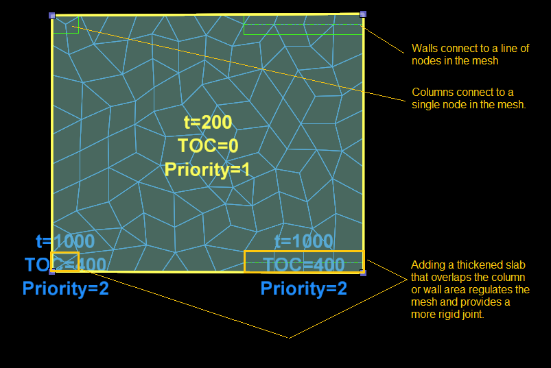

Why is there deflection at the face of a supporting column or wall?
Columns in Ram Concept connect to the slab finite element mesh at a single node located at the column centroid. They are not solid objects nor do they provide vertical support to multiple nodes. This is apparent viewing the Elements - Standard Plan.
As such, deflections in the slab start from that node and increase towards the face of the column. For small columns this may not matter much, but for large area columns this is significant.
To mimic the behavior of a stiff column support, we suggest modeling a thick and stiff slab object that overlays the column volume like a mini-drop cap. Be sure to assign a higher priority to this patch of concrete. It is recommended to model this patch with an elevated top of concrete elevation such that the slab centroid aligns with the mid-depth of the patch in order to avoid eccentricity at this joint.
The same approach could be taken for thick walls supporting the slab as well. A beam or slab object can be used there.
In version 8.02 a feature was added to automate this process. Refer to Rigid Support Zones in RAM Concept.

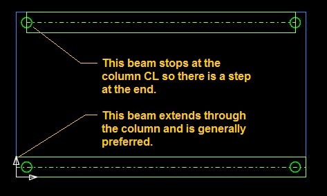

Where should you define the end points of a beam, at the face of the column, passing the column or at the center line?
The general preference is to model the beams through the column, extended to the slab edge since it best matches the built condition and how things are formed. Stopping the beam at the column centerline results in a slightly more flexible system.
