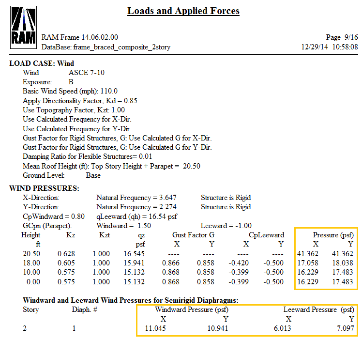

You can see the total force using Process – Results – Applied Story Forces, or Report - Loads and Applied Forces to see the intermediate wind pressure calculations.

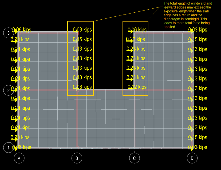

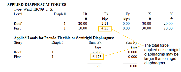

Why is the total applied wind load on a semirigid diaphragm more or less than a rigid diaphragm?
The total length of windward and leeward edges may exceed the exposure length when the slab edge has a return (like a "U" shaped structure) and the diaphragm is semirigid. This leads to more total force being applied (when using program generated wind loads) since all these edges are loaded based on the pressure, story height and mesh size.
The Report - Loads and Applied Forces lists both values to be clear:

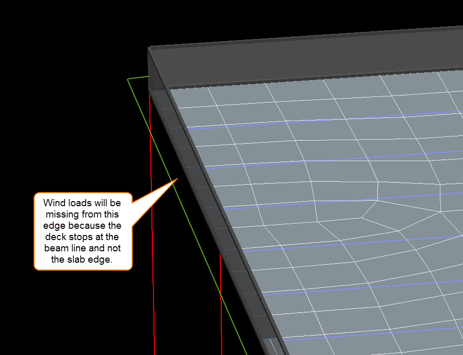

Furthermore, when wind loads are applied to a meshed semi-rigid diaphragm only the windward and leeward edge nodes are loaded. if the applied deck does not extend to the slab edge overhang, then the program will fail to find the edges to load and the total applied load will then be less than it should be. It's imperative that the deck extend to the slab edge when using semi rigid diaphragms.

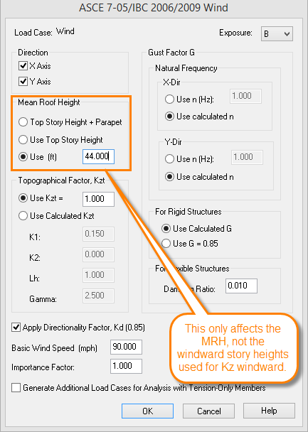

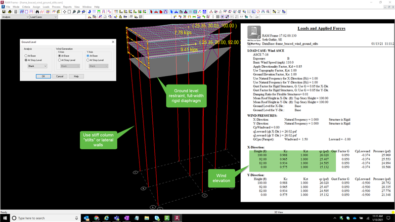

Can the entire RAM SS model be elevated like a structure on top of a podium to get the correct wind pressures?
Starting in version 17.02, you can build an elevated first story to place the rest of the model upon. This level could be as simple as a set of lateral columns under the columns above, or a set of lateral walls to support everything above. Make the columns vertically very stiff. Then set this first level to the ground level for Analysis, while leaving the ground level for Wind Load Generation "At Base".
Note, in the wind load definition there is a property for Mean Roof Height which is taken as the top story height be default. The user can override this value which will alter the pressure, but when calculating the windward pressure, the original story heights above ground are still used. In other words, the program is not adjusting Kz windward based on the input mean roof height.
If you actually raise the structure, by adding a blank first story with height = h1,  it will elevate the structure and raise the wind pressure correctly, but it will also assume that the exposed height of the lowest level diaphragm is larger by h1/2 giving you too much force on the lowest framed level. This can be confirmed using the Loads and Applied forces report and the Exposure Boundaries report.
Thus it's better to model something physical for the lower supporting structure.
