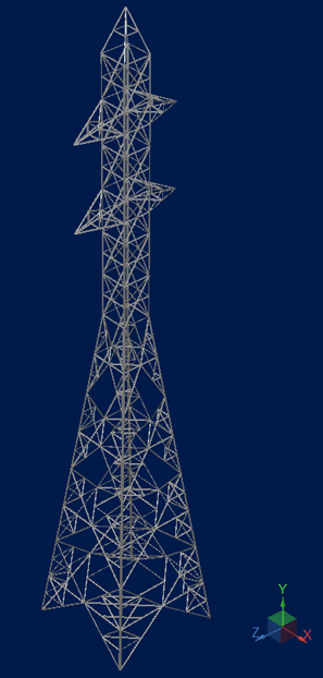

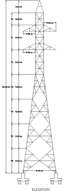

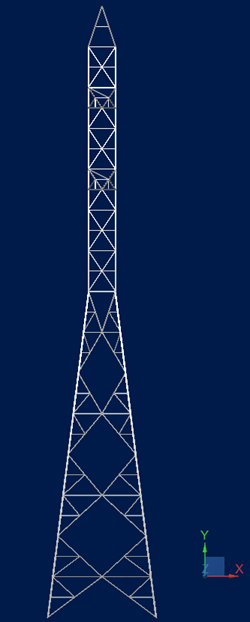

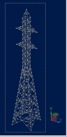

Open the “45.00m-height electrical tower.retx” model. The structure is formed by A36 steel equal leg angles for all segments and elements in the tower. The configuration is typical for electrical transmission towers.
                                   3D model                                                                Lateral view
All support bases are assumed to be pinned for the four-legged tower.

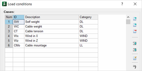

The referenced model has been created with the previous loads. This example is focused on assigning the wind loads using the wind loads generation tool for members.
Lateral loads to apply:
The model already has several design and service load combinations based upon ASCE 7-16 code.

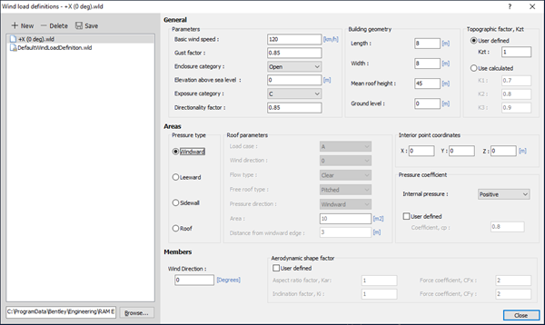

  1. The wind loads definition manager can be accessed from the Home tab, and Definitions > Wind.
  2. A dialog window opens. In this dialog, press +New in the top left toolbar to create a new wind definition. Note that once a new item is created, it may be deleted and saved after modifying the values in the fields at the right part where wind load data is shown.

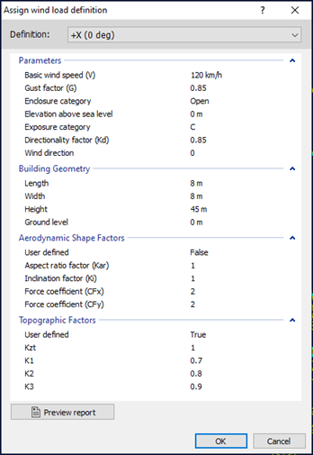

  3. Create a new definition for wind load with the +X axis direction and setting the direction to 0 degrees in the dialog region for Members. Edit the rest of the information in the manager fields using the following data:

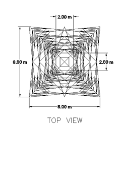

  1. Enter the structure geometry in the Building geometry group of data, as follows:
    1. Length, 8.00 m.
    2. Width, 8.00 m.
    3. Mean roof height, 45.00 m.
    4. Ground level, 0.00 m.
Note. The tower dimensions are used to fill the geometry of the building. These field are defined in ASCE/SEI 7-16, Minimum Design Loads and Associated Criteria for Buildings and Other Structures, chapter 26 and chapter 27, Directional Procedure, Part 1.
  • Length: The length value is always the dimension of the structure parallel to the wind direction as it is shown in the image above.
  • Width: The width value is always the dimension of the structure perpendicular to the wind direction as it is shown in the image above.
  • Mean roof height: The Mean Roof Height is defined as the average between the roof eave height and the elevation of the highest point on the roof surface. For roof angles of less than or equal to 10°, there is an exception and the mean roof height is permitted to be taken as the roof eave height.
  • Ground level: Is the level or vertical coordinate (Y) that represents the ground level of the structure.
  1. Enter the wind parameters in the Parameters group, as follows (refer to notes at the end of this section for an explanation of each field):
    1. Basic wind speed, 120 km/h.
    2. Gust factor, 0.85.
    3. Enclosure category, Open.
    4. Elevation above sea level, 0.00 m.
    5. Exposure category, C.
    6. Directionality factor, 0.85.
    7. Wind direction, 0 degrees. This will coincide with the positive global X axis direction.
Note. The previous data is defined in ASCE/SEI 7-16, Minimum Design Loads and Associated Criteria for Buildings and Other Structures, chapter 26 and chapter 27, Directional Procedure, Part 1.

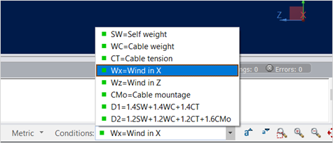

  1. Select the load case for which the wind loads will be assigned.

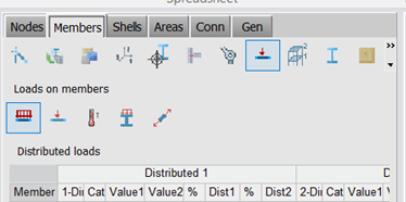

2. Select the desired members to assign wind loads using the tool. For this example, select all the members in the tower model since the tool can assign wind loads at once for the whole selection for one wind direction.
3. Select the Members > Loads on members spreadsheet.
4. On the Spreadsheet ribbon tab, select the Assign wind loads tool in the Active spreadsheet tools group.
The dialog to assign Wind load on members opens.
  1. Select the “+X (0 deg)” load definition and press OK.
  2. To see a report of calculated wind loads for selected members before confirming the assigned values in the dialog press the Preview report button and a report window will be displayed.

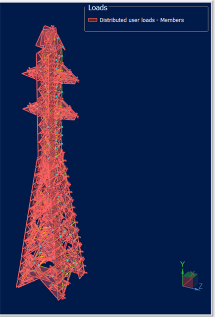

  1. Once the dialog is closed, the wind loads are added for the current load case for all the selected members.

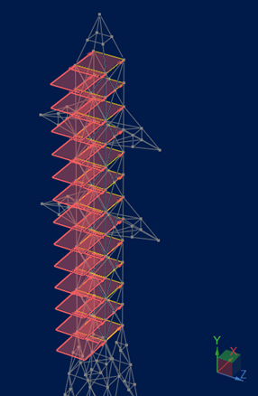

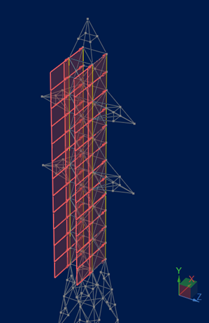

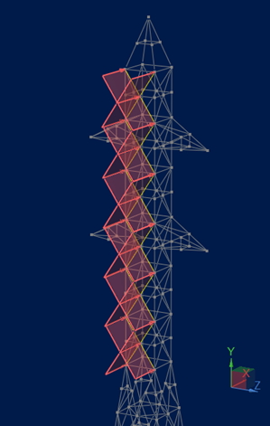

Wind loads on horizontal members
Wind loads on vertical members
Wind loads on diagonal members
Wind loads on all tower loads

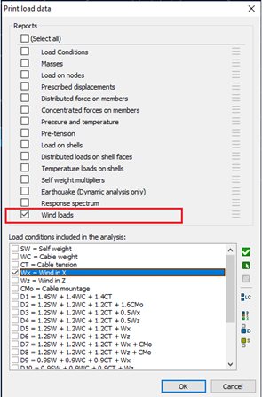

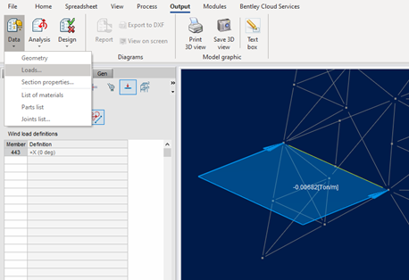

  1. After the wind loads are assigned, it is possible to access a wind loads report for the selected members, by looking for the Output tab, in the Reports group, the Data button and search for ..
Then select the Wind loads option for a desired load condition:
