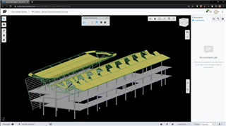

Bentley iTwin Design Review is a collaborative service hosted on the web that allows two or more interested parties to communicate with one another in the context of a 3D model or, more accurately, an iTwin.
The iTwin Services Add-in within the desktop application publishes the analysis model to an iTwin Design Review session, and therefore into an intuitive point of collaboration that facilitates review of design work in progress (see Figure 1).
Figure 1- A model as presented in-product (STAAD) and corresponding iTwin Design Review session in the browser with coordination discussion.
The web-based interface (accessible with a web browser) of Design Review offers a set of commands for navigating, viewing from different perspectives, isolating key elements, and clipping views.

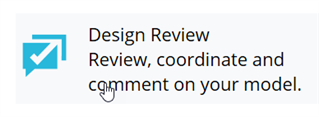

  1. Click the iTwin Services button  in your product. See Table 1 for its relative location in your product.
  1. After which the iTwin Services sidebar would present itself (see Figure 1). Select Design Review within the services offered under iTwin Services (as presented in the sidebar).
Figure 3 - Select Design Review under iTwin Services

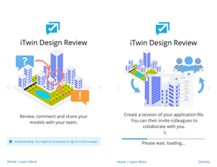

  1. The default web browser may appear and you will be prompted to sign-in using your CONNECT credentials and grant the necessary rights. Once acknowledged, the access token is saved on your machine for 30 days (eliminating the need to sign in again during this time).
Figure 4 - Application requests access. Click Allow to grant the necessary rights to proceed.
Figure 5 - iTwin Design Review authentication splash screen and subsequent loading page. Click Home to return to iTwin Services page.

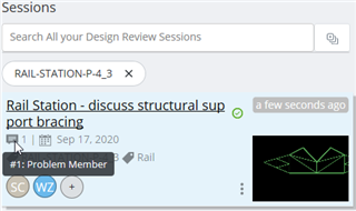

Each iTwin Design Review Session (see Figure 9) is shown as a list item in the Sessions List.
Figure 7 - A iTwin Design Review session list item with legend key
A: Displays the iTwin Design Review Session Name along with the status of the session. Click on the Session Name to open the session in the default browser. Chrome, Firefox or the new Edge browser (based on Chromium) is recommended for the best design review experience.
           Indicates that the session is currently being converted online.
           Indicates the session is ready to be accessed.
           Indicates there was an error in the session creation process.
B: Supplementary information regarding the session.
          Indicates the number of comments for this session. A mouse hover over this icon would show the comment subject titles in this session.
          Indicates the creation date of this session. Hovering of this icon would reveal a more detailed timestamp.
         Shows the assigned Tag(s) to this session. Clicking any of the Tag(s) would filter all sessions to the selected Tag.
C: Displays the user initials of participants of this session. Hovering over each initial would reveal the full name of participants.  Clicking the “+” icon allows you to Add or Remove participants (see Figure 10). Auto suggested list of participants (from your organization) would display as you type into the Add Participants field. You can also add external participants to your design review session.
Figure 8 - Edit Session Participants Dialogue
D: Displays when the session was last modified (relative to the current date/time).
E: Thumbnail of the session. When you first create a session, this would be a blank placeholder. The thumbnail of the design review session is automatically retrieved from the view extracted from the first comment entered in the iTwin Design Review session.

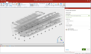

2.3    Creating a New Session
Click “Create Session” in New Session block (Figure 8) to launch Create New Session form.
For below steps Refer to Figure 10 for the elements on Create New Session form.
Figure 10 - Create new session form
1) Session Name - The name of the session will be suggested based on the name of the model. However, note that this should be unique (amongst All Open Sessions) and as such if a session has been initiated with the name of the model already, then an alternative name should be provided.
2) Define any tags. (Optional)The name of the model is provided as a suggested tag, but any others can be added to help in getting collections of sessions at a later stage.
3) Session Participants - (Optional) Define additional participants. Clearly the power and benefit of a design review session comes from the collaborative effort of working with colleagues. They can be identified at this time or any time later once the session has been initiated.
4) Session Settings – (Optional) Product specific settings on HOW a session is to be created (e.g include loads, rebars, etc..).

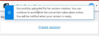

5) Next – Clicking ‘Next’ will then start the process of building the Design Review model from your model and push it into the iTwin Design Review service. The desktop conversion process may take a few minute to process, once the desktop conversion has completed you will be informed of this via an info message (Figure 13). At this stage, the process is purely online, therefore you can continue to work in your product while the conversion takes place online. Your session is “ready” when you see an info message per (Figure 14) or a green tick  next to your session list item
Figure 11 - Successful upload message

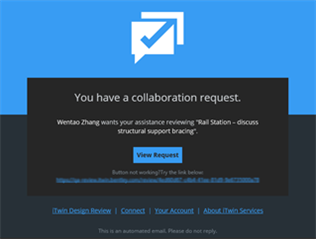

Your invited participants would similarly be notified through Connection Client and email message (Figure 16).
Figure 16 - Collaboration request email automatically sent by iTwin Design Review to all Session Participants.

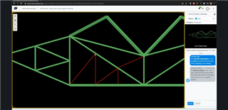

Figure 17 - iTwin Design Review session in the web browser
Figure 18 –Comment and markup of proposed solution in an iTwin Design Review session in the web browser.
