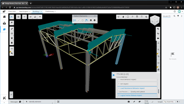

This means the Engineers model (and subsequent changes) can now be part of the wider team. iModels (containing the Engineers model and models from other disciplines) can be viewed and collaborated upon in the web browser. Features include (but not limited to): viewing of model in browser, measurements, issues resolution, clash detection, geolocations, data visualization and version comparison (Figure 1).
Figure 1 - A model originating from ISM Repository shown in the browser

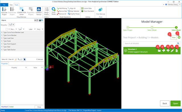

Projects host iModels, and iModels themselves can contain multiple Models. It is the Models themselves that form a relationship with your selected file base repository (*.ism.dgn). See Model Manager as a sidebar (Figure 4). Model Manager provides a simple 1-2-3 wizard to navigate to an iModel and provides interaction to the selected Model.
These interactions include ability to:
  1. View iModel in browser.
  2. Create a New Model within an iModel. If a file-based repository is already opened, it will be use as basis to initialize the model.
  3. Open a selected Model for viewing in iTwin Analytical Synchronizer.
  4. Push– Compares and uploads the changes from your opened repository to the selected Model.
  5. Pull– Compares and downloads changes from the selected Model to your currently opened repository.
  6. Edit the model description .
  7. Delete the model.

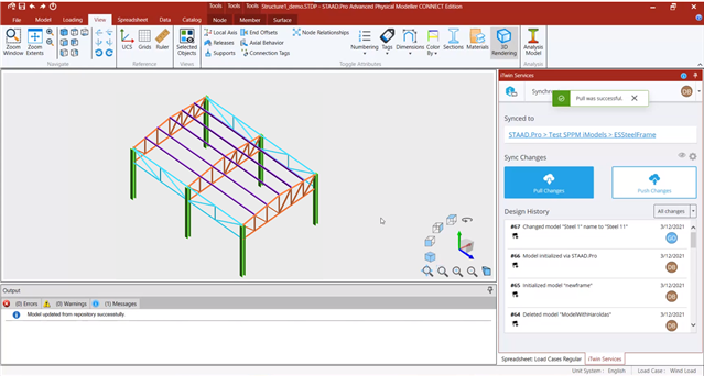

Furthermore, this version of iTwin Analytical Synchronizer is a prerequisite to allow for direct in-product (e.g STAAD, SACS, RAM) interaction with iModelHub via push/pull buttons in the sidebar (see Figure 5). For a general overview of iTwin and Engineering Analysis applications see iTwin Services for Engineering Analysis
Figure 5 - In-product synchronization with iTwin Services (iTwin Analytical Synchronizer is a prerequisite for synchronization workflow)
