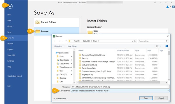

RAM Elements can automatically save a single compressed zip archive file including the primary Ram Elements file (.retx or .etz), the finite element analysis results (.fem) along with any custom sections, materials or other database information required.
Steps
To do this go to File - Save-as - Browse and choose the .zip format and select the desired file name and location.
Always send such a zip file or a BugReport file when submitting any service request or posting to the RAM | STAAD Forum, especially when the file includes custom data.
If you want to open a zip file prepared by another user, use File - Open - Browse... and choose file type of .zip.

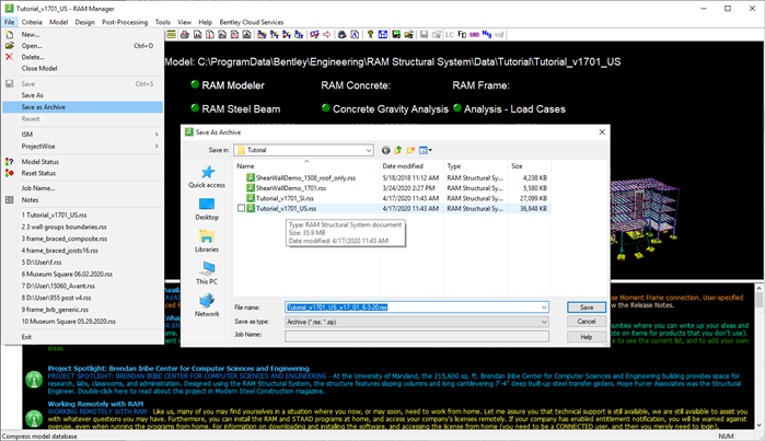

For RAM Structural System Starting in version 17.01, use Ram Manager - File - Save as Archive to create a backup file without analysis results. The save-as dialog will appear and the default file name with match the original with the version and date added as a suffix.

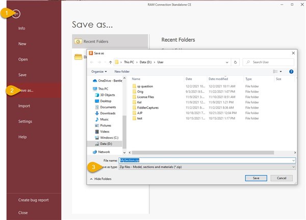

For Ram Connection Stand-Alone use a similar process to Ram Elements, steps below:
