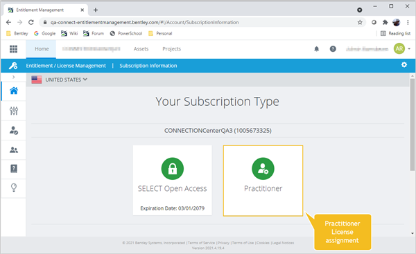

Step 3 - Open the Entitlement / License Management tile.

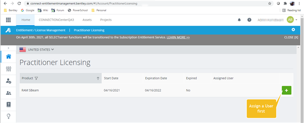

Step 4 - There should be a tile on the Home screen that indicates Practitioner. Click to open the Practitioner Licensing window.

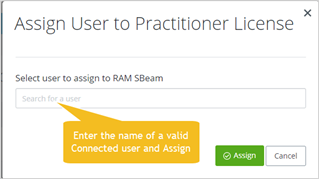

Step 5 - There should be a row that indicates RAM SBeam. Click the Green + on the right end to Assign.
Step 6 - Enter a valid Connected User Name and click Assign.
For information on adding users, see: Registered user - Administrator Process
