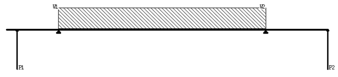

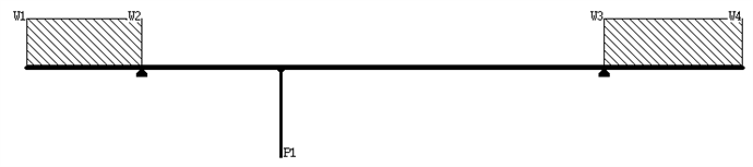

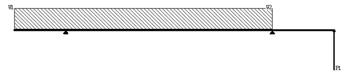

As required by Code, when a beam is cantilevered at one or both ends RAM Steel Beam Design skip loads the Live load on adjacent spans and alternating spans such as to create the maximum moments, deflections, and reactions. Not only does RAM Steel Beam Design skip load the Live loads, it applies the Positive and Negative loads on alternating spans such that the worst conditions are calculated.
The following skip load condition is performed to calculate the maximum positive moment (top flange in compression):
The following skip load condition is performed to calculate the maximum negative moment (bottom flange in compression):
The following skip load conditions are performed to calculate the maximum shear force:
To determine the maximum support reactions, the program uses a similar approach. The reported reaction is the total reaction at the support. For example, this image below shows the live load pattern to determine the max reaction at the left support for a double cantilever condition:
To determine the critical shear reaction on either side of the support it is recommended to use the shear envelope diagram.
