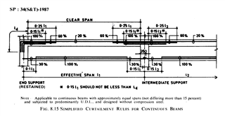

- RCDC provides all the Lapping location as mentioned in SP34 except for L/10 so as to avoid the interpolation of Bending moment in between a section length.
- At top location, the lapping is provided at curtailment locations. i.e. L/3,L/4 or L/6 distance from column face. Here the distance 2xD is not checked for curtailment. If we start providing curtailments for beams as per the beam depth, it would be complicated. The curtailment location will vary as per the beam depth. The location of curtailments might fall between two stations. Checking reinforcement curtailments at any location as per 2D would not be simple and might not give the desire result. Interpolation of forces is not possible for in between values. Even if we consider on higher side, it would not be consistent to all beams and curtailments will not match the distance 2D for all beams. Also, it is very difficult to handle Ast calculations and shear check location for individual beams.

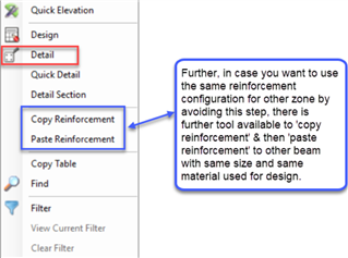

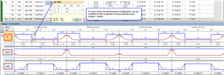

Note that there is an option in RCDC to perform local curtailment by modifying the reinforcement locally for any station of a zone. On the design output window, you can click on the 'Detail' feature and by double click on each zone, you can modify the 'Top reinforcement', 'Bottom reinforcement' & 'Shear reinforcement' also.
Further, in case you want to use the same reinforcement configuration for other zone by avoiding this step, there is further tool available to 'copy reinforcement' & then 'paste reinforcement' to other beam with same size and same material used for design.
Refer the attached video for understanding how this can be done.
