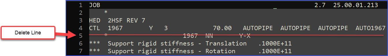

5. Next, select File> Save As > AutoPIPE Batch (*.NTL), enter file name to save as NTL.NTL.
6. Open the NTL.NTL file in a text editing application (ex. NotePAD++, MS Word, etc..)
a. Delete the 2nd line of the CTL card, or line #5 of the file (imaged below).
b. Save the file as NTL.NTL.

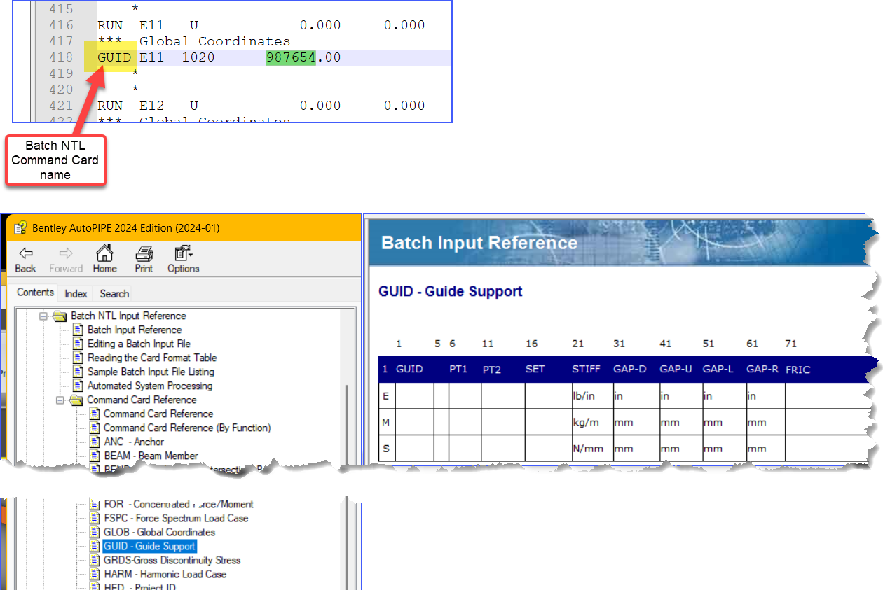

5. How to find the command card for a specific setting in an AutoPIPE model?
