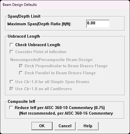

How can I set the unbraced length of the beam?
In Ram Steel, the unbraced lengths of beams are always calculated by the program. For details on exactly how this is done refer to the Ram Steel Beam Manual (RamSteelBeam.pdf), section titled Technical Notes - Unbraced Length.
Under Criteria - Design Defaults, the user can opt out of considering the unbraced length by unchecking the option to Check Unbraced length, but this could be unconservative since all beams will then be assumed fully braced.
Additional brace points can also be modeled in the Modeler using Layout - Beams - Brace points.
