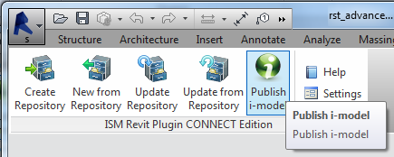

Publish to i-model
The ISM-Revit Plugin now allows Revit models to be published to i-model format. Both i-model formats: the *.i.dgn format (optimized for desktop use) and the *.imodel format (optimized for mobile use) are supported. The i-model format can be viewed on Apple, Android, and Windows mobile devices using Structural Navigator. More information on Structural Navigator can be found here.
The i-model publish command allows models to be uploaded to Personal Share space (My Shared Files) on Bentley Cloud Services, making it easy to access models from mobile devices while away from the office. Structural Navigator is Bentley’s mobile app for the review of structural i-models.

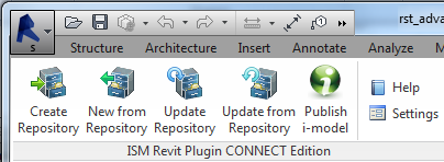

The ISM Revit Plugin enables a round trip exchange between Revit® and Bentley’s Integrated Structural Modeling (ISM) format, therefore also enabling a round trip exchange between Revit and any other ISM-enabled application. RAM Structural System, RAM Concept, and STAAD.Pro are examples of applications that are ISM-enabled and can interoperate with Revit with the help of the ISM Revit Plugin.
The ISM Revit Plugin adds commands to Revit that allow ISM repositories to be created and updated from Revit, and allow Revit to create and update ISM repositories. The ISM Revit Plugin is dependent on ISM and thus Structural Synchronizer must be installed on the computer.
