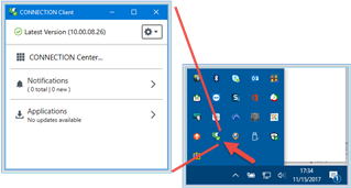

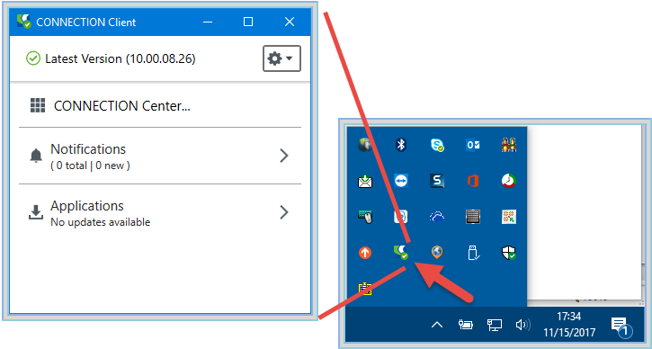

AutoPIPE CONNECT 11.01 and higher
Starting with AutoPIPE CONNECT 11.01. and higher user will be notified by Bentley CONNECTION Center. This is an app that should appear in your system tray:
When a new Update for the software is available, Select the Applications button, select the application to be installed, and press "Install Selected" button
