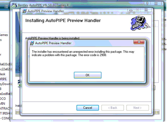

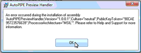

The following appeared when installing AutoPIPE:
The installer has encountered an unexpected error installing this package. This may indicate a problem with this package. The error code is 2908.
Error:=1603

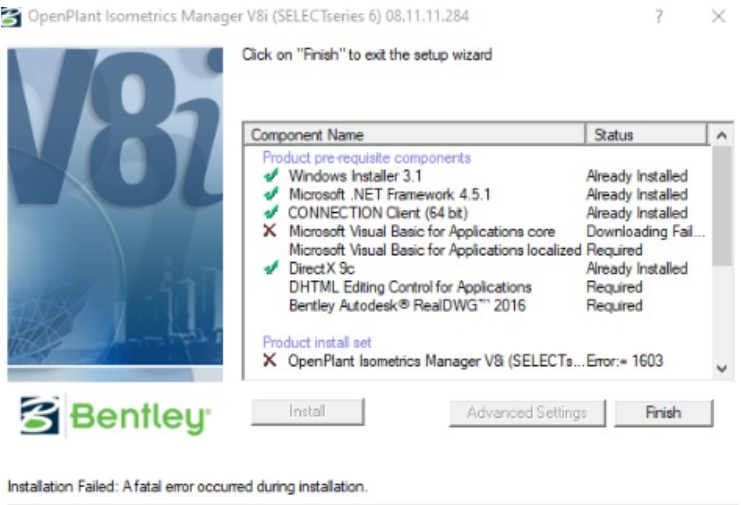

- As of Jan 2024, one may encounter this issue because of updated security measures (example, DHTML) . Take a moment to look at the image to identify all of the Product Pre-requisites whose status is not set to "Already Installed" or "Installed". Try to download these application separately from their original manufacture web sites and install them before installing Bentley software.
Unfortunately, Bentley is no longer able to distribute these pre-requisite applications due to security concerns. Previously, they were available as part of the "Prerequisites for Bentley Desktop Applications" on our software download site. However, going forward, the only way to obtain these applications would be through the original manufacturers' website. We understand the inconvenience this may cause and sincerely apologize for any difficulties you may encounter while installing other manufacturers' applications as prerequisites for Bentley applications. Please contact the original software manufacture for software availability and technical support for installation issues. If one of the prerequisites is an Bentley V8i or earlier application, please remember our support policy, certain programs are no longer supported or available. This would be a hard stop with this installation. We apologize once more.

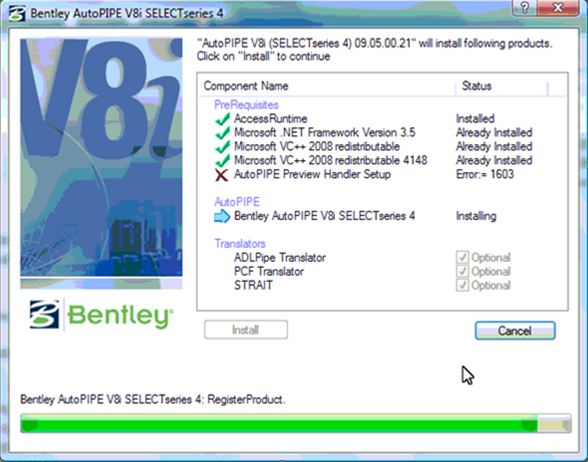

1. Open the Programs and Features control panel.
2. Select Microsoft .NET Framework 3.5 SP1 in the list of installed programs.
3. Click the Uninstall/Change button just above the list (see attached screenshot).
4. In the window that appears, the Repair option should be chosen already. Click the Next button to proceed.
5. Once the repair is complete, attempt to install AutoPIPE and any dependencies by running Setup.exe in the ap09050021en folder again.
- Notes: Some IT departments have reported struggles with getting this package repaired/working. Trying to repair the Microsoft. NET Framework 3.5 did not work initially and neither did attempting to re-install it (either installing it direct before trying to install AutoPIPE, or letting AutoPIPE do the Microsoft. NET Framework 3.5 installation). Both approaches still got the same errors mentioned above. We even searched for updates/M-soft fixes and tried to run those on it to no avail.

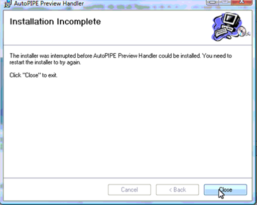

- If this occurs investigate if Microsoft. NET Framework v4 is installed. If so, deleted it off the system (and checked for any other versions too), and then installed Microsoft. NET Framework 3.5 directly from file 'dotnetfx35.exe' from M-soft's website. This installed with no errors and subsequently AutoPIPE, AutoPIPE acceptance test, the structural dashboard and the license tool should now install with out error.
- Completely remove all previous version of the Application, reboot the system, and then Download and Install AutoPIPE V8i 09.06.01.xx or higher. This newer version of the program has a new installer that is more streamlined to avoid issues such as this.
