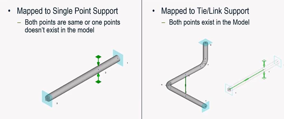

1. #390010: Add support for two endpoint supports while importing PCF file

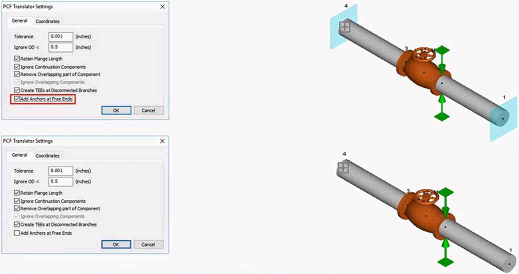

2. #394331: Add an option to add/ignore anchors at free ends.
3. This includes enhanced handling for the support card with more than one connection points. Following logic is introduced
a. If both end points of a support are the same coordinate, it is imported as a point support
b. If only one end point of the support is found but the other point is not found (coordinate search), it is imported as a point support
c. If both end points of the support are found, we place a tie link support between the 2 points

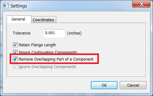

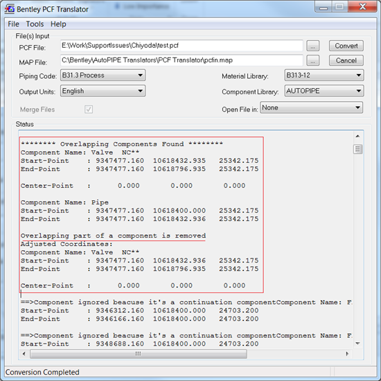

1. #11048 PCF Translator: Program should remove overlapping part of a component.
We have added a new option to remove the overlapping part of a component. This option is by default on. The option to ignore overlapping component and remove part of component are naturally exclusive of each other so if one is enabled, other becomes disabled.
User is also warned of the affect in the log as shown below.
