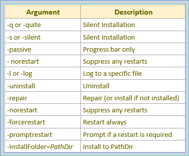

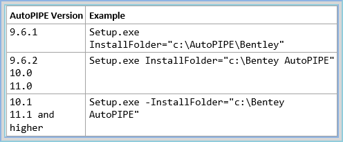

AutoPIPE 9.6.1 and 12.08.xx
AutoPIPE uses a WiX installer. To perform a silent installation, extract the contents of the package to the BentleyDownloads folder. Then run Setup.exe with a switch from a script or the Command Prompt
To change default installation directory, use the "InstallFolder" switch as recommended below
Notes
1: DO NOT use a backslash (\) at end of folder path when path is enclosed in commas ("").
2: There is an issue in AutoPIPE 9.6.1 installer. Please check this wiki for workaround.
