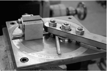

In this News, we present a case study of the bending of a titanium rod. The experimental set up is depicted in the figure below.
Figure  The experimental set up for bending a titanium rod
The experimental device consists of 2 rollers and an arm. The stationary roller guides the titanium rod while the moving roller bends it.
