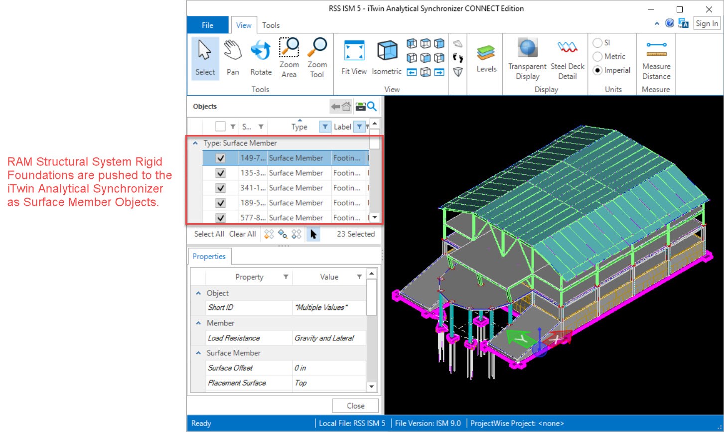

Pushing Rigid Foundations from RAM Structural System to the iTwin Analytical Synchronizer
Surface Members - Foundations
RAM Structural System rigid foundations are pushed to the iTwin Analytical Synchronizer as Surface Member objects.
Surface Member Properties
RAM Structural System footing properties can be viewed for each Surface Member object in the iTwin Analytical Synchronizer.
iTAS Surface Member Property
RAM Structural System Foundation Property
System Kind
Indicates the type of material used to model the member in RAM Structural System:
  • Steel in RAM Structural System = Steel Rolled in iTAS
  • Concrete in RAM Structural System = Concrete Unspecified in iTAS
Use
Indicates the member type in RAM Structural System:
  • Spread Footing in RAM Structural System = Footing in iTAS
  • Continuous Footing in RAM Structural System = Footing in iTAS
  • Pile Cap Footing in RAM Structural System = Pile Cap in iTAS
Surface Offset/Placement Surface
In RAM Structural System, all foundations at the base of columns or walls. In the iTwin Analytical Synchronizer, the surface offset and placement surface will be automatically set as the following:
  • Surface Offset: 0 in
  • Placement Surface: Top

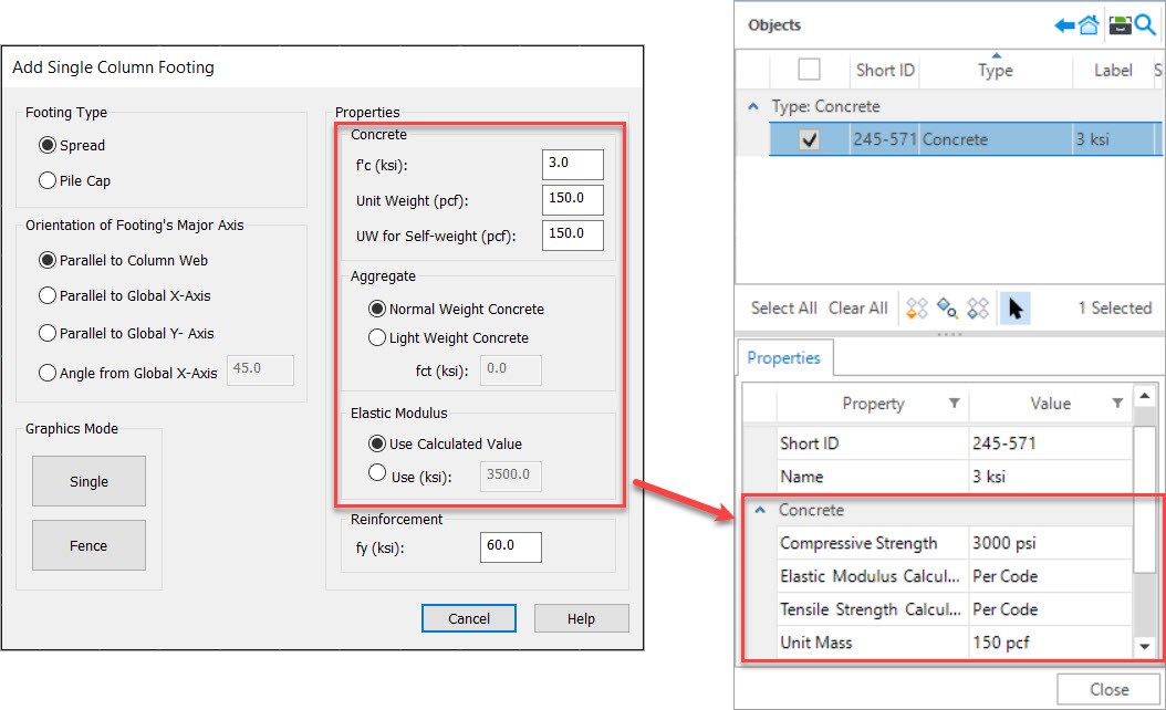

Material Properties
RAM Structural System, material properties are defined for each concrete foundation when it is modeled. The material properties will be pushed to the iTwin Analytical Synchronizer as Concrete objects.

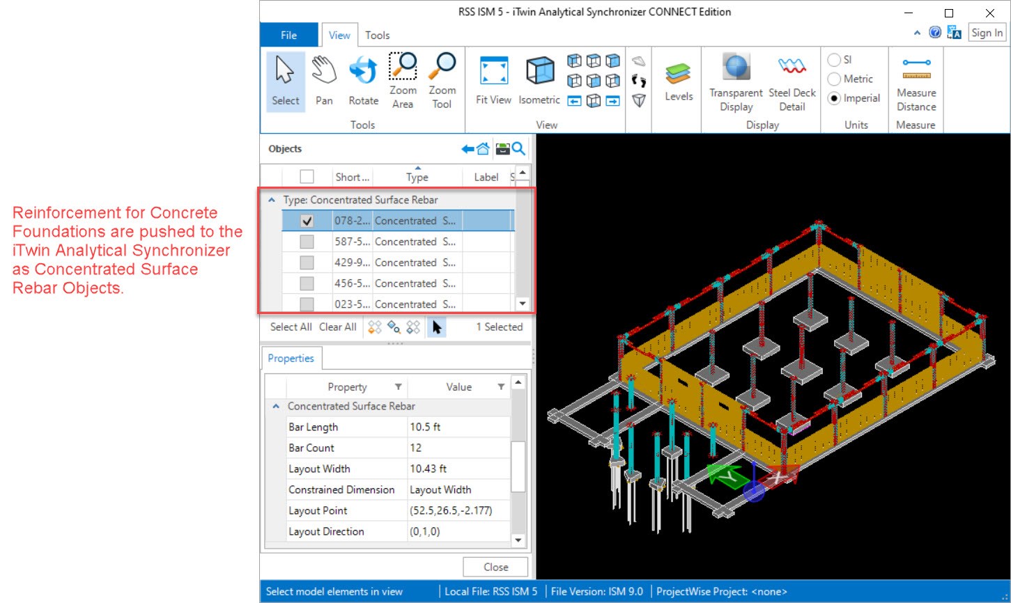

Foundation Reinforcement
In RAM Structural System, reinforcement for rigid foundations is designed and detailed in RAM Foundation. The rebar will be pushed to the iTwin Analytical Synchronizer as Concentrated Surface Rebar Objects.

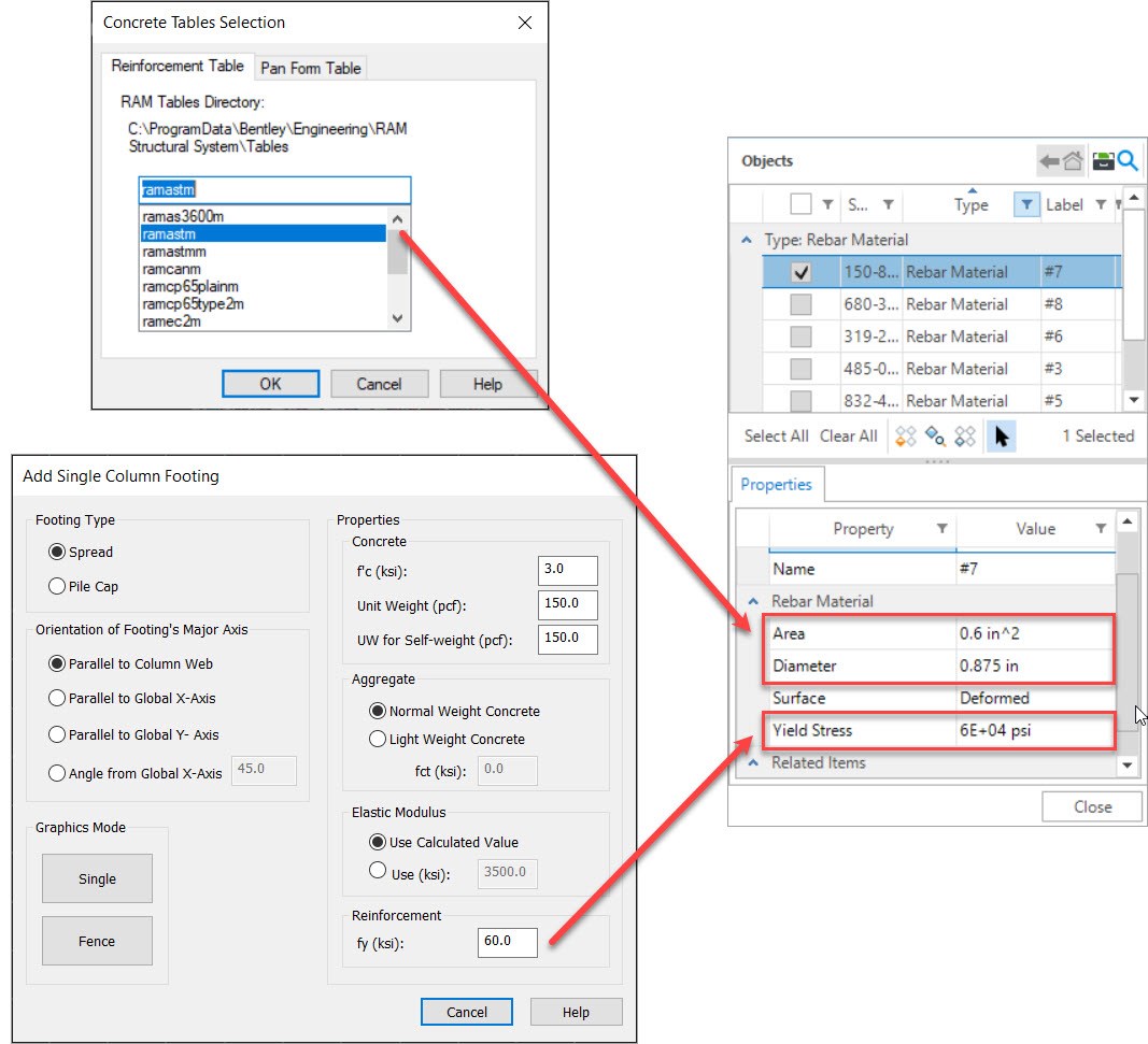

Rebar Material Properties
In the iTwin Analytical Synchronizer, the Rebar Material properties for each type of bar used in the model can be viewed, including the bar area, diameter, and yield stress.
