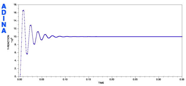

In the second example, we demonstrate the use of a non-diagonal damping matrix to obtain the static response in explicit time integration. This approach of solution for the static response can be valuable when very large finite element models need to be solved, and the factorization of the stiffness matrix is computationally very expensive or the matrix is quite ill-conditioned. In this simple illustrative solution, the reaction force on a rod is to be predicted. The rod, modeled with 20 truss elements, is fixed at one end and subjected to a compressive force at the other end. To obtain the static solution, Rayleigh damping is introduced
Using the Noh-Bathe method, the load can be applied rapidly and the static response is obtained in only 300 time steps. Figure 3 shows the results obtained for the reaction at the fixed end.
Figure 3  Predicted response using the Noh-Bathe method
