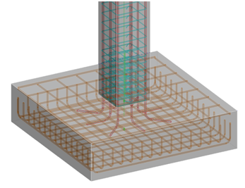

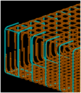

Reinforcement
ISM can now transfer, coordinate and visualize steel reinforcement in concrete structures. All of the typical reinforcement in columns, beams, footings, slabs, mats/rafts and walls can be modeled in ISM.
Reinforcement can use standard detailing parameters (for example, per ACI 318 or AS 3600) or can have custom bends and hooks defined. Bars can be epoxy coated, galvanized or plain. Post-tensioning is not included in this release.

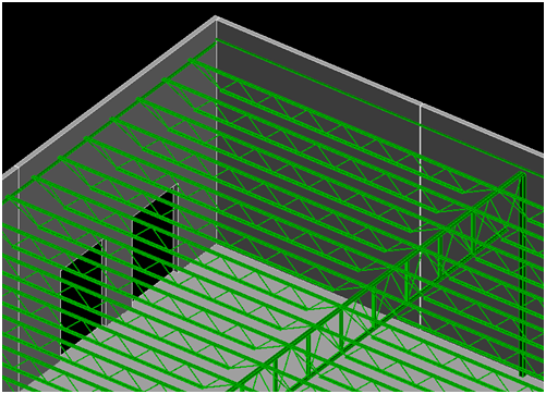

Steel Joists
ISM can now transfer, coordinate and visualize steel joists. All of the Steel Joist Institute (SJI) standard joists (“8K1”, etc.) are supported, as well as SJI joist-girders and parametric steel joists.

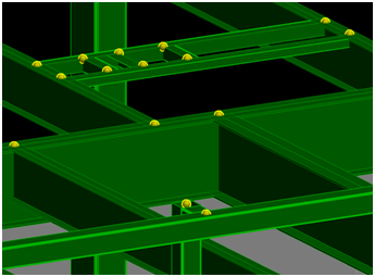

Shear Studs
ISM can now transfer and coordinate shear studs on steel beams.

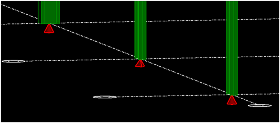

Nodes and Boundary Conditions
New analytical information has been added to ISM 2.0. Nodes and boundary conditions can now be transferred, coordinated and visualized. It is not intended that ISM track all of the nodes in an application’s analysis model. Applications only set the “key nodes” in ISM. “Key nodes” are those that define the intent of how members are connected, but do not include nodes that are only used to subdivide a member into more refined elements.
Nodes in ISM can have boundary conditions applied. Boundary conditions can restrain six degrees of freedom, and can be fixed, spring or one-way (compression-only or tension-only).

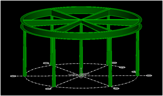

Curved Beams
 Beams and slab edges can now be curved. Only circular curves are supported, and slabs must still be planar.
Grid Systems
 Orthogonal and Radial Grid Systems are now supported.
