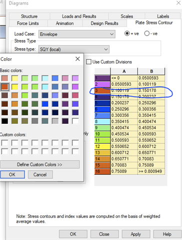

Refer attached snap. Highlighted range color was changed to RED. How to reset the color to default ??
Close the STAAD application and reopen it. It should be reset. This changes are not save anywhere and stored during the session only. Closing and reopening the program will reset it.
