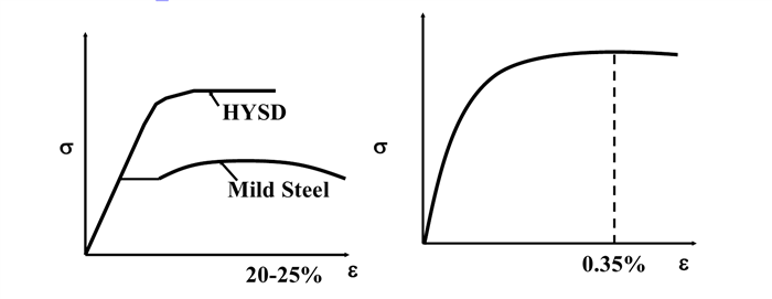

Materials in RC Members:
Concrete and steel have very different characteristics
Steel ductile: strain capacity: ~12% to 25%
Concrete brittle: strain capacity: ~0.35%

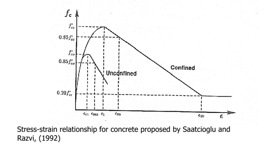

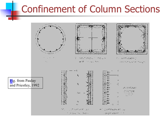

Confinement of concrete:
It considerably improves its strain capacity:
Main Steps:
To ensure ductility:

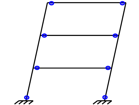

Storey collapse Mechanism:
Beam –Hinge Mechanism (Sway Mechanism):
Preferred mechanism
Ensure that beams yield before columns do
Strong Column –Weak Beam Design
