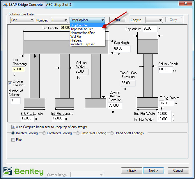

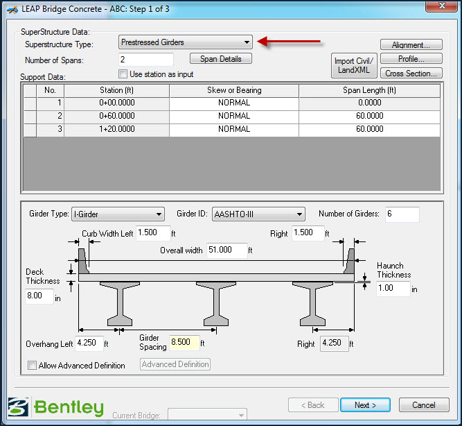

1) Pre-stressed Girder -- Integral Pier option is not available in Substructure Dialog Box.

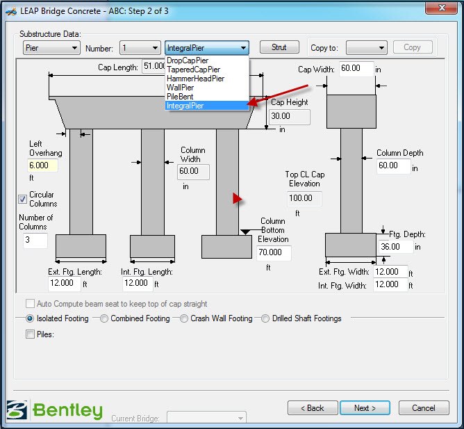

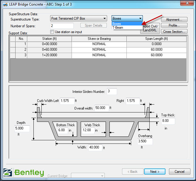

2) Post Tensioned Box/Tee Girders -- Integral Pier option is available in Substructure Dialog Box.

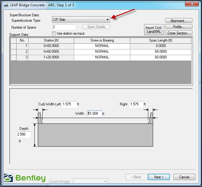

3) CIP Slab Bridge --  Integral Pier option is available in Substructure Dialog Box.
Please see the attached Screenshots .
