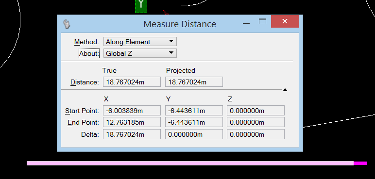

Where did the coordinate readout setting go in order to change the accuracy of the measuring tools?
 Product:MicroStation
 Version:V8 XM
 Environment:N\A
 Area:Measure
 Subarea:N\A

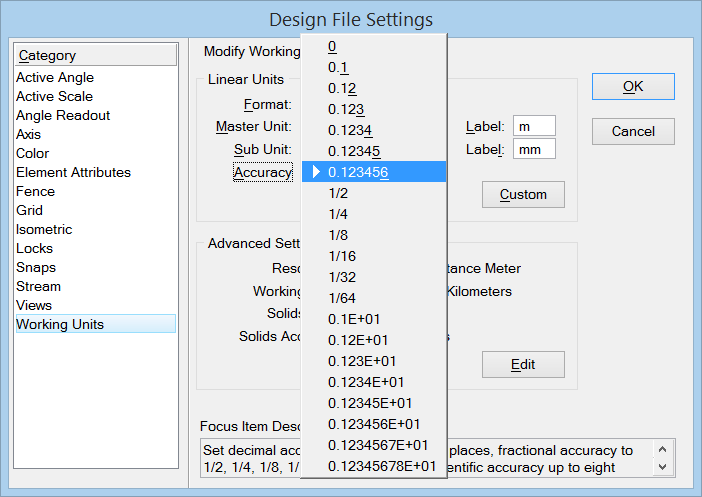

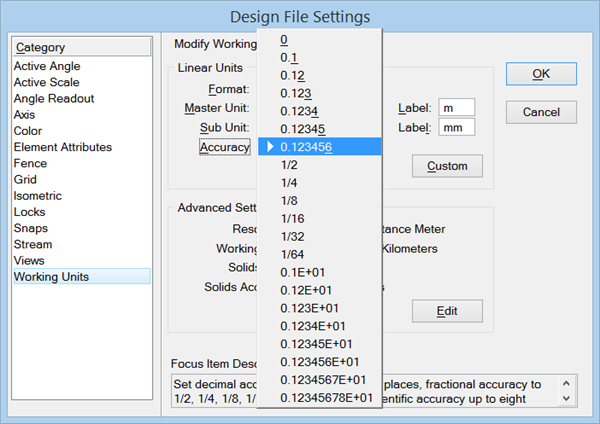

The coordinate readout in MicroStation XM has been combined with the Working Units under the Design File Settings (Settings > Design File > Working Units).
Changing the accuracy for the Linear and for the Angular settings will affect the measuring tools.
