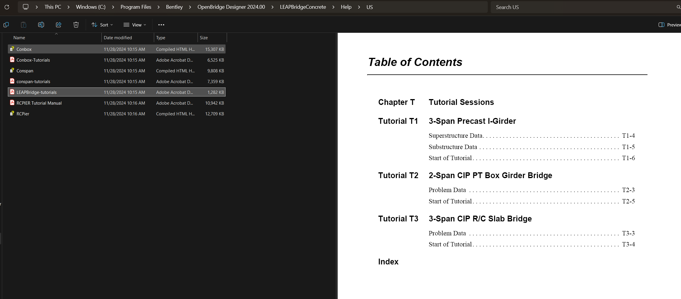

There are .pdf documents with the step-by-step instructions.
The PDF of the Tutorial volume is located under the Help folder of the LBC inside the OBD version installation, as shown below.
The example files that can be used as a reference are under Examples, country: US, Canada, India; and the product modules.
