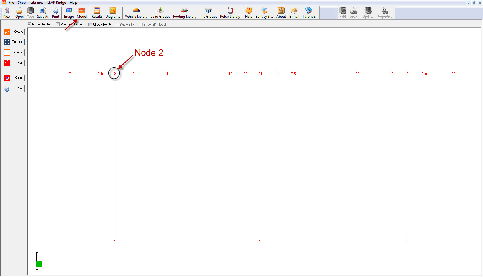

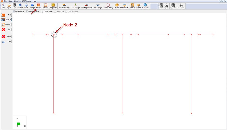

QUESTION: How to get the Displacement/Deflection information at the Top of Pier or Column ?
ANSWER:

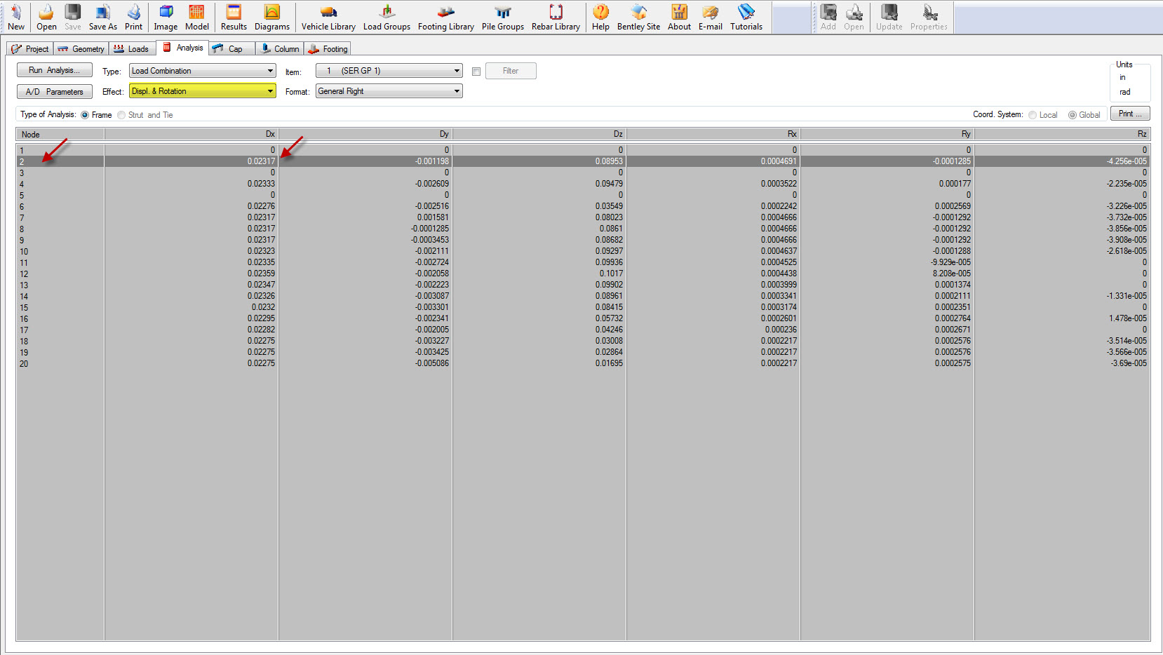

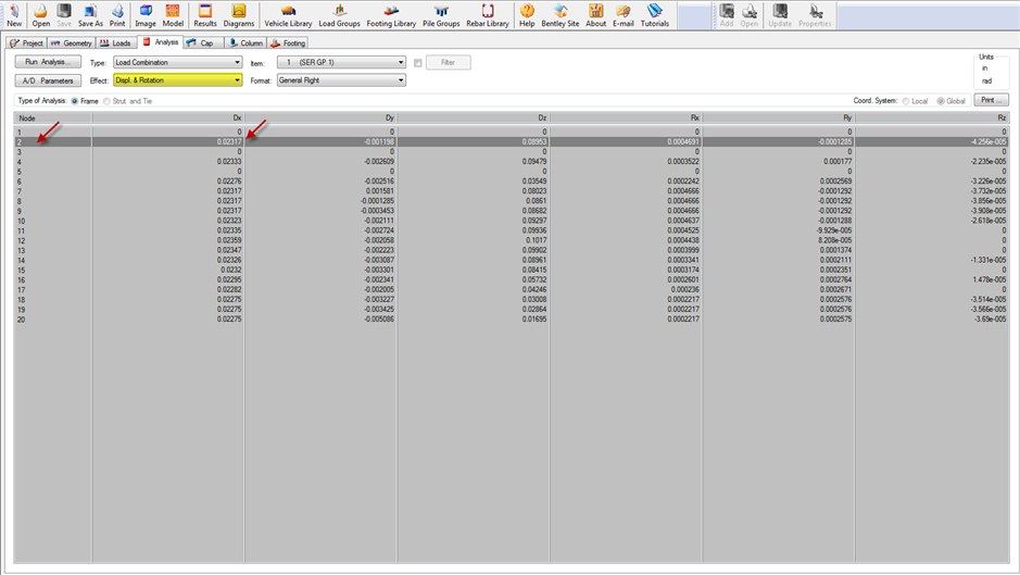

To get the displacement or Deflection information at the top of pier user needs to run the analysis in the Analysis TAB.
Then in the EFFECT drop down menu user needs to select "DISP. & ROTATION" option.
Then under Dx , Dy & Dz user can get the displacement values at different Nodes.
Please see the attached screenshots for more information.
