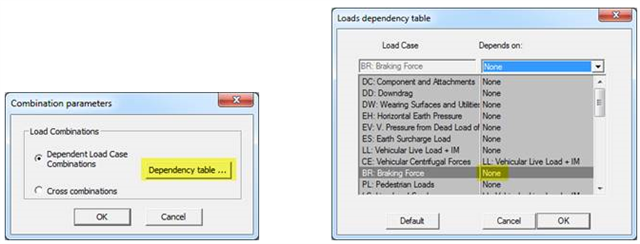

- If you have breaking force generated with live load, please delete all the Braking forces and just leave one braking force BR1 and then generate the load combinations. Since braking force and Live load are related , Please click on the combination option, click on Parameter option and then select Dependent Load case combinations and then click on Dependency Table and in the new window select BR option and then select NONE from the drop down menu.

- Finally try to generate all the load combinations by selecting "Dependent load case combinations" instead of cross combinations. If “Dependent Load case” combinations doesn't work then use cross combination and run the program.
