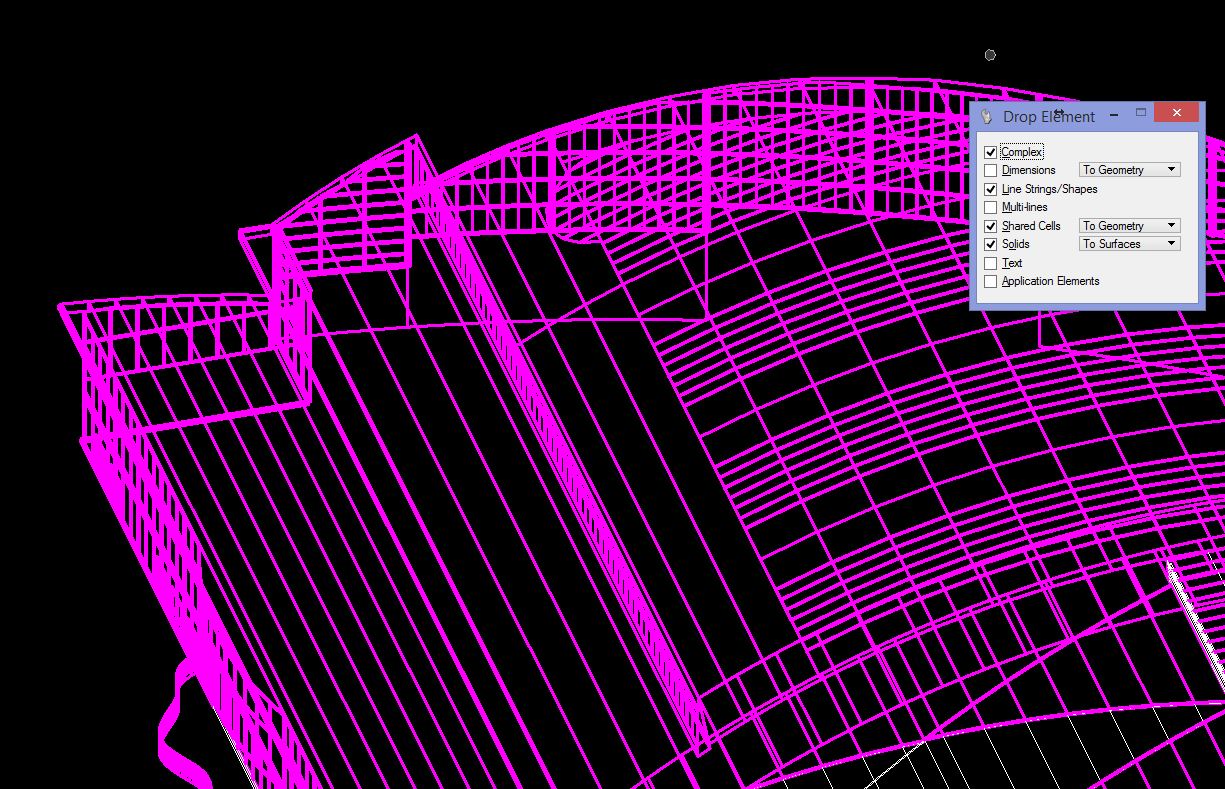

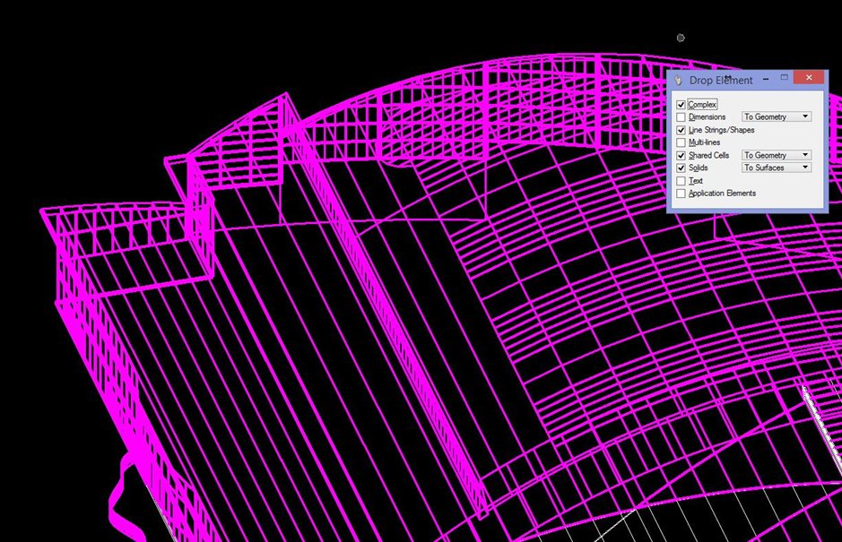

Problem Description
When exporting a Microstation 3D Model with standard element types to STL file format much of the exported model does not convert. This can be verified by viewing the exported STL file in various viewers or by importing the STL file back into another Microstation design file.

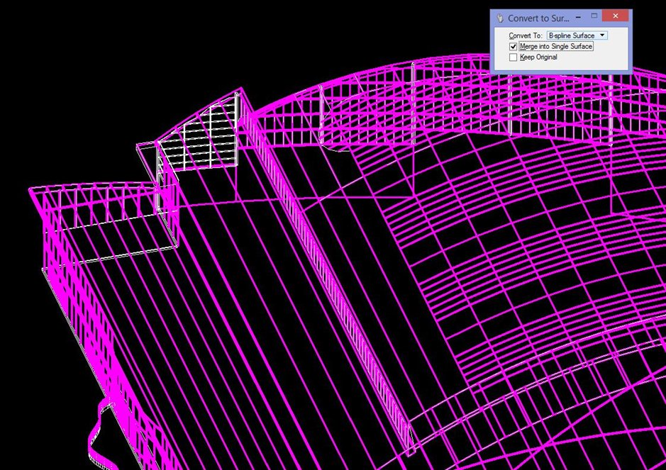

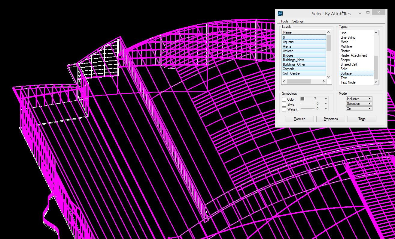

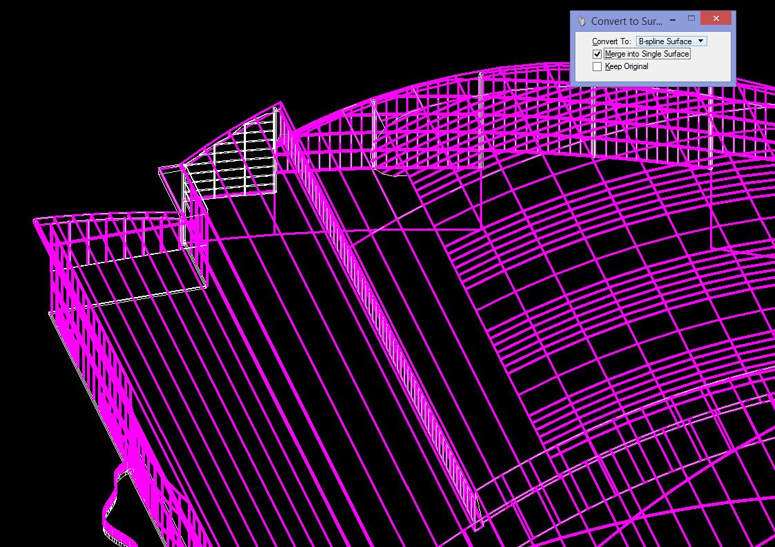

Looking at the types of elements used within various 3D design files produced in MicroStation it was found that Surface type elements were not able to convert to an equivalent elements in the STL file format.
To resolve this problem it is suggested to convert these Surface elements to another type.
