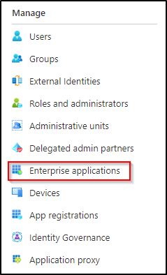

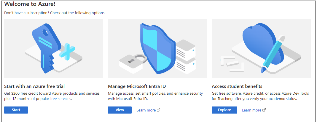

1. In the Azure portal, from the middle navigation panel, select "Manage Microsoft Entra ID".
2. Go to "Enterprise applications"

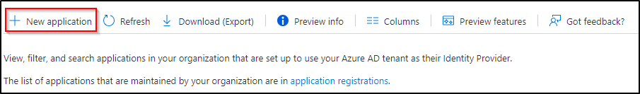

3. To add a new application, select the "New application" button at the top of the pane.

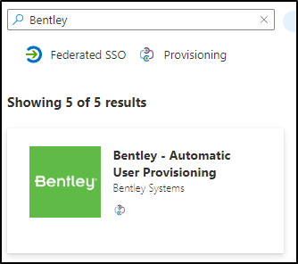

4. Search "Bentley" and click on the Bentley application:

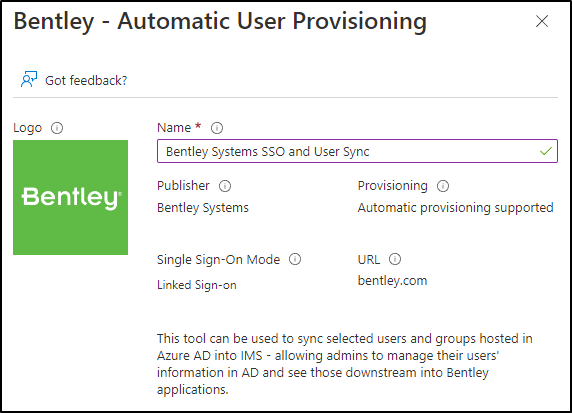

5. You may keep the name of the application, rename it to reflect your own preference, or rename to "Bentley Systems SSO and User Sync" to reflect that this app will be used for both.
6. Select "Create" at the bottom of the page on the right. After a few moments the page will automatically redirect you to the enterprise application that was just created to support this work. This also created an app registration with the same name at the same time.

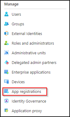

2. Select "App Registrations" from menu on the left:
3. Select the app registration with the same name as the enterprise application you just created.

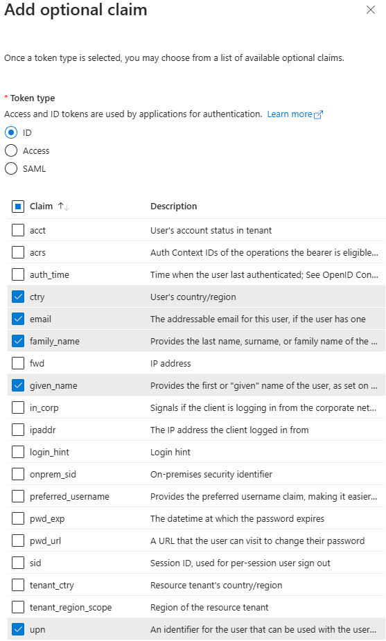

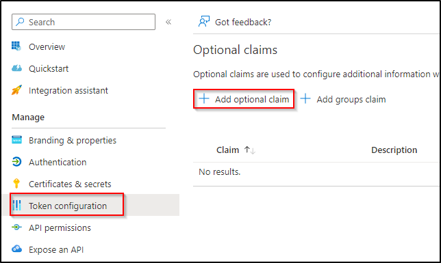

4. On the left-hand side go to "Token configuration" and select "Add optional claim" to set up the details we will receive in your id_token.

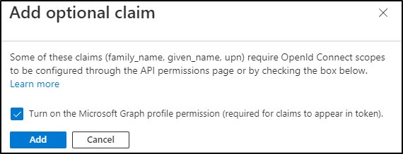

5. Select "ID" as the token type. From the menu that populates, select "ctry", "email", "family_name", "given_name", "upn". Then hit add. A pop up will prompt for the Microsoft Graph permissions required to access these details. Click the checkbox to grant the permission, and hit add. Please work with us to determine the appropriate identifier for looking up users on our end, whether email address or User Principal Name (UPN).

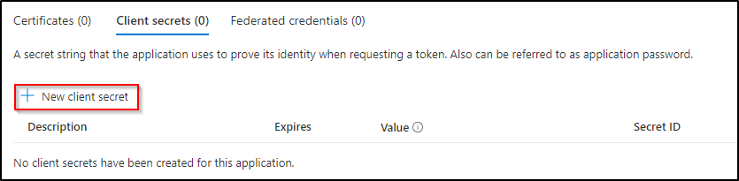

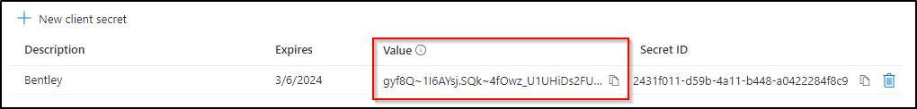

6. On the left, go to "Certificates & Secrets", and click on "New Client Secret".
7. For the description field provide "Bentley". Expiration is up to your organizations discretion. Most commonly secrets are issued for 6 months or 1 year, but may vary depending on your organization's security stance regarding client secret rotations. Click add once an expiration as been chosen.
8. A new client secret will populate on the page. Use the clipboard option to copy the client secret value. We do not need the secret ID. Keep note of the secret on a notepad as you will not be able to see this value again once you navigate away from this page.

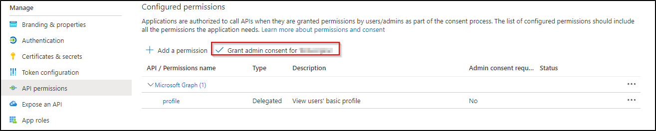

9. (OPTIONAL) Federations which utilize OIDC present a consent screen to the user when they go to authenticate for the first time which allows for access to the users data. The user must provide consent or they will get an error returned when trying to authenticate. To avoid the consent screen all together, your Azure AD admin can grant admin consent on their behalf. This allows for access to an end user's data during authentication without prompting for consent. NOTE: This does not give Bentley access to all of your users data. This only allows the Azure AD application to access the data of the user who is performing authentication. To do this, select "API Permissions" from the left and hit "Grant admin consent for <your org name>":

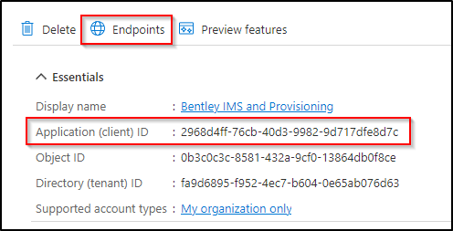

10. Now go back to "Overview" to collect the other necessary details for federation. From this page you can gather the Application (client) ID and add it to your notepad, then select "Endpoints":

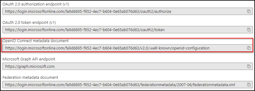

11. From the Endpoints tab, copy the "OpenID Connect metadata document" URL from the center of the menu:

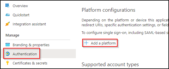

12. Provide the gathered Client ID, Client Secret, and Metadata URL to the Bentley IMS team. The Bentley IMS team will use these provided details to set up your federation for testing. The Bentley IMS team will provide instructions back to you which explain how you can test. The instructions will also have you input Redirect URI's in order to finalize the OIDC set up. When you have received these URL's, go the Authentication tab on the left hand side and select "Add a platform":

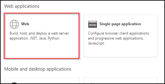

13. Select "Web" from the options:

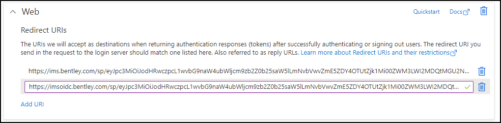

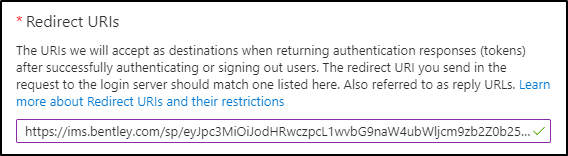

14. In the Redirect URI's section, supply one of the two provided redirect URI's and hit configure:
15. In the Web platform that has now populated the authentication tab, select "Add URI" and provide the second URL that the Bentley IMS team provided you and hit save at the bottom:

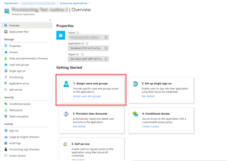

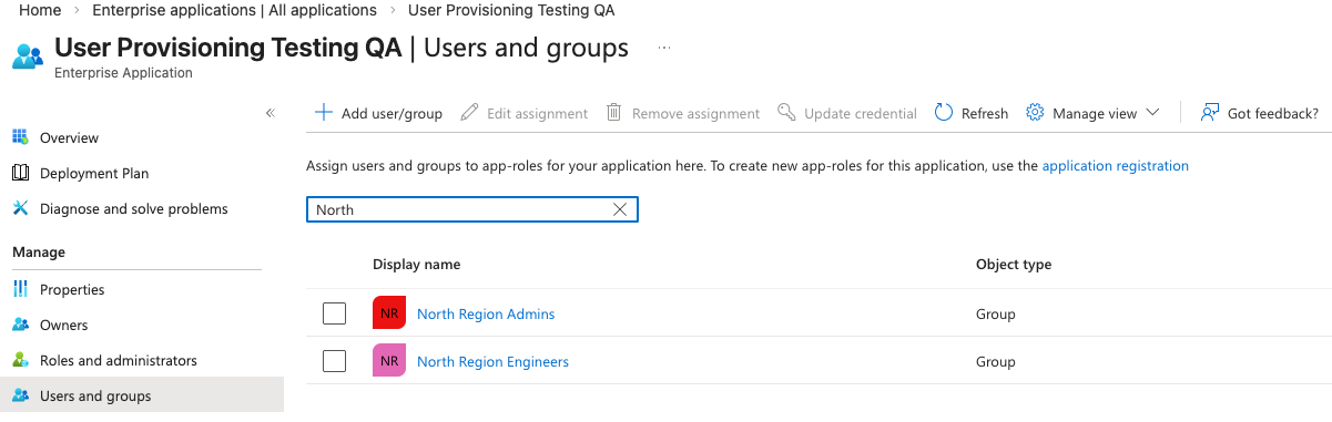

To add users/groups, go to the Bentley User Provisioning Application:
During testing, only supply the users that you would like to have test. Once you have confirmed that the federation and sync are both working as expected, we'll have you update the Users and Groups section to ensure that all of your Bentley users are loaded into the Users and Groups section.

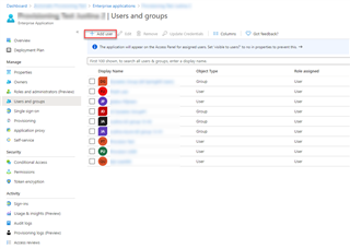

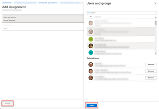

  1. Open the application and click "Assign users and groups" from an Overview page
  1. On the opened page click “+ Add User"
  1. Click on the “Users and groups” section and choose users or groups that you want to synchronize into the Bentley system, select and click “Assign”.
Users and groups will be synchronized on the next provision run.

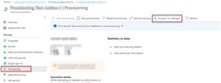

1. Go to Provisioning section of the application in the Azure Portal:

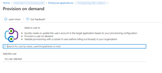

2. Click On-Demand Provision. A new page should open:
3. Enter the user you want to Provision/update Attributes and click Provision:

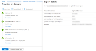

4. The user should be provisioned instantly and the results are shown on the same page.
