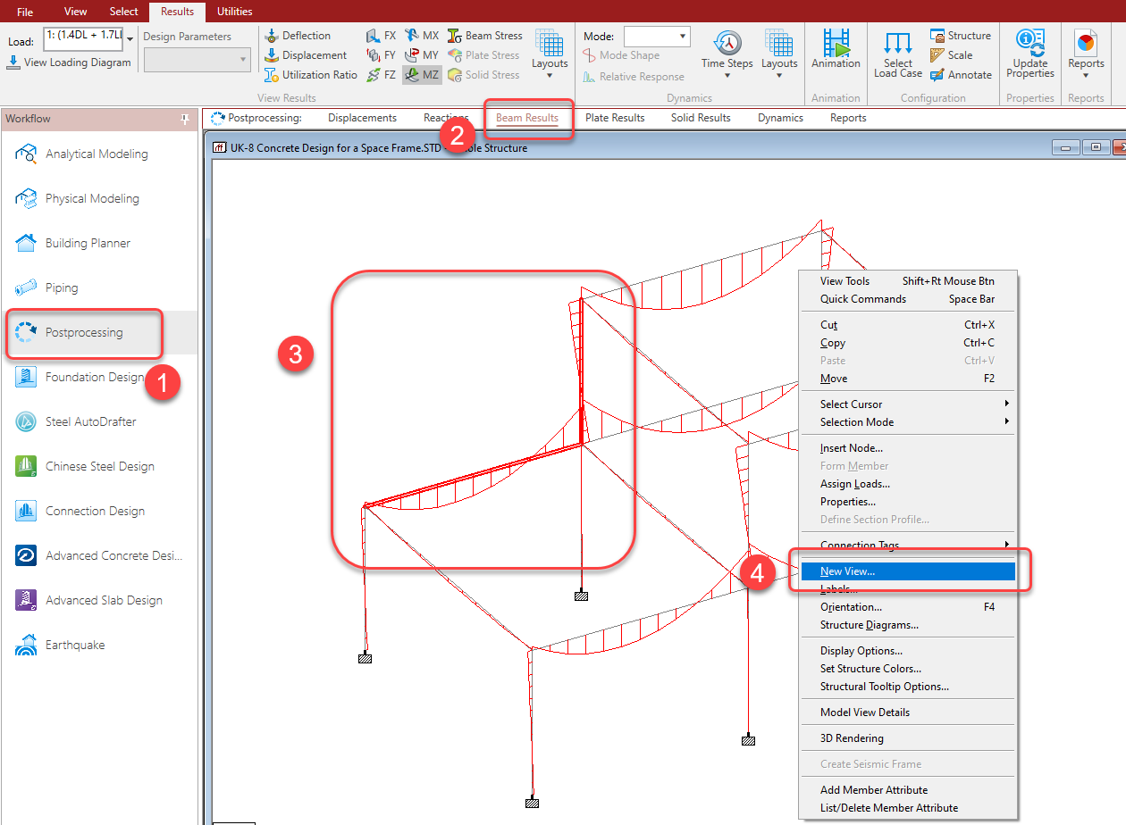

How can I plot the Bending Moment on a selected set of members ?
Here are the steps
- Go to the Postprocessing workflow, Beam Results page.
- Select the members ( you can press CTRL button and click on multiple members to add to your selection )
- Right click choose New View > Create a New Window for the View > OK to display only the members selected.

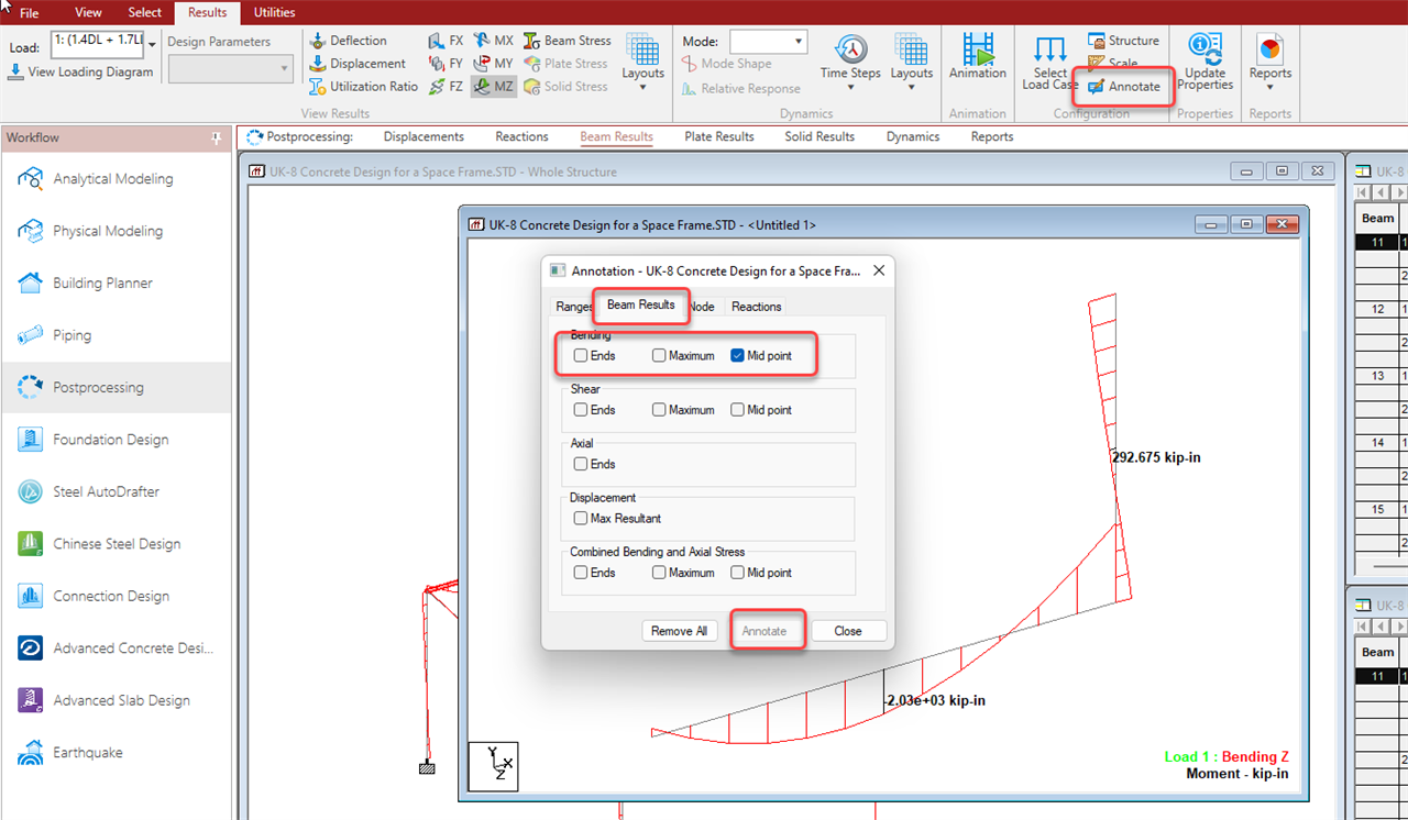

- The BMD should be plotted by default if you are in the Beam Results page, if not, turn the display for bending moment on.
- You can also plot the values of the moments on the diagram too by selecting the top menu option Results > Annotate > Beam Results > Bending > Choosing an appropriate item and clicking on Annotate.
