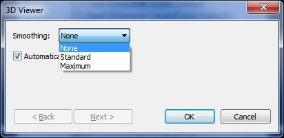

Why are my graphics chunky or blocky looking?
RAM Structural System uses open GL based graphics. Many graphics adapters are set up for high performance, but reduced quality graphics which is preferred for high speed gaming, but not really necessary for engineering work. With these adapters there is usually a way to improve the quality but the program also has an option to override the graphics adapter and let the operating system handle the graphics in our 3D viewer. To use this option got to RAM Manager - Tools menu - Defaults Utility.. - (Last Option) 3D viewer - and set Smoothing = None.
This should eliminate the chunky type graphics or triangulated graphics you might see.
The same tip can also fix problems where some element types (particularly the columns) are not showing up at all.

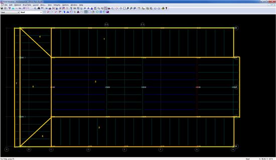

I modeled a roof with multiple slopes, but in the 3D view the deck is a single sloped plane shooting up.  How do I fix this?
Starting in version 14.0, the program will display the surface of the deck in 3D.
For a sloping deck to function correctly in this regard, the deck must be input using a separate polygon for each sloping surface. In other words, for a gable roof, two deck polygons should be defined, one for each side or slope of the roof.  A whole-floor application of the deck is no longer sufficient.
It is suggested to snap to the beam end points when defining these decks, since the beam end points have exact elevations which are derived from the supporting column or wall elevations. Here's a better way to lay out the deck polygons for the model illustrated above:
Even slight imprecision in the support elevations (i.e. warping of the deck) can cause this anomaly in 3D.
The analysis results will only be affected if the warped deck is part of a semirigid diaphragm in RAM Frame or is defined as a two-way deck.

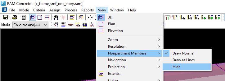

Why are some of the members not shown in the Design Module or 3D view?
Within each design module there is a tool called View - Nonpertinent Members that can be used to control how the other members that are not being designed in the current module should appear. The options are Normal (all members are drawn the same), Lines (single line mode for non-pertinent members) or Hide. Pick any option other than Hide to see all members.
The ability to turn off the display of member types (e.g. gravity columns or lateral walls) and the slab/decking is also possible through the View - Members dialog or the Hide/Show icons on the toolbar.
