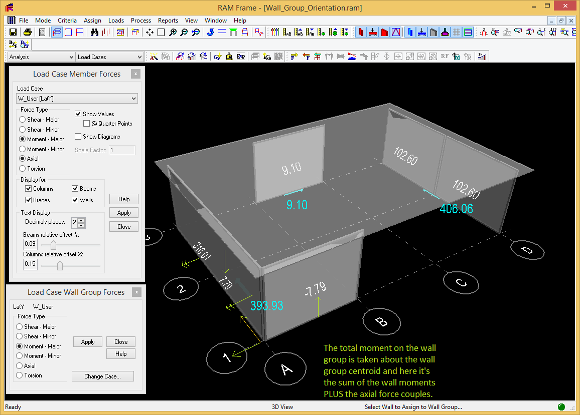

By assigning wall groups to a collection of walls and columns, you can report Wall Group Forces which represent the resultant total forces, axial shear and moment, acting about the centroid of the wall design group.
This is most useful for determining the entire overturning moment on a collection of walls.
Total Moments on a Wall Group

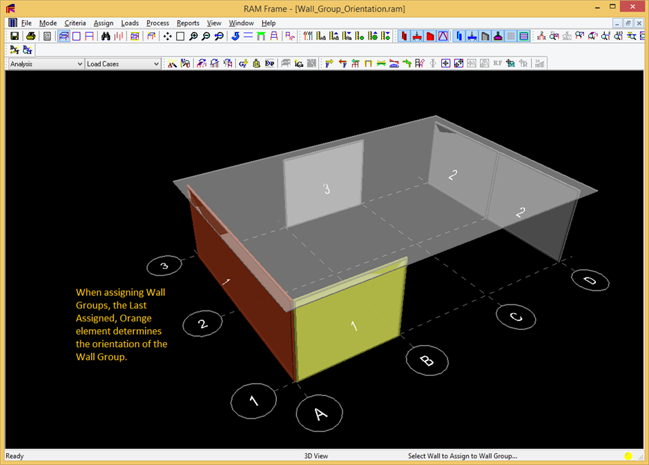

When you are assigning wall groups to members in the model, the last selected element determines the orientation of the Wall Group. This element is painted an darker orange color to highlight it.

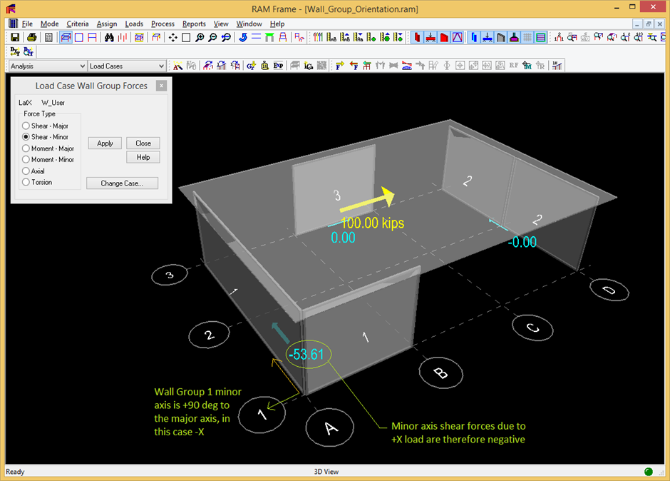

This "orienting element" sets the major axis for shear forces similar to the way columns are treated (see RAM Steel Columns FAQ). Shear forces parallel to this wall are reported as major axis shear forces. Forces acting +90 degrees to this axis are reported as minor axis shear forces. Moments about this 90 degree axis are Major axis Moments.

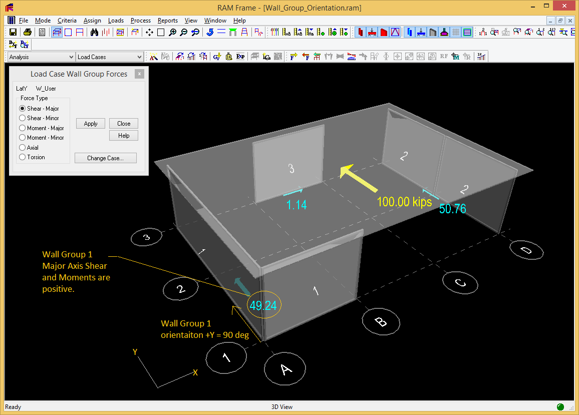

In the figure below the long wall on Grid A runs North-South parallel to the global Y axis, so forces from south to north yield positive major axis shears and moments.
Major Axis Shear
Minor Axis Shear
If there is a case where the Major and minor axis forces are opposite hand from your expectations, check the wall group orientation. When assigning Wall Groups, the last assigned, orange element determines the orientation of the Wall Group. The yellow elements are the others in the group.
Assigning Wall Groups Sets the Orientation

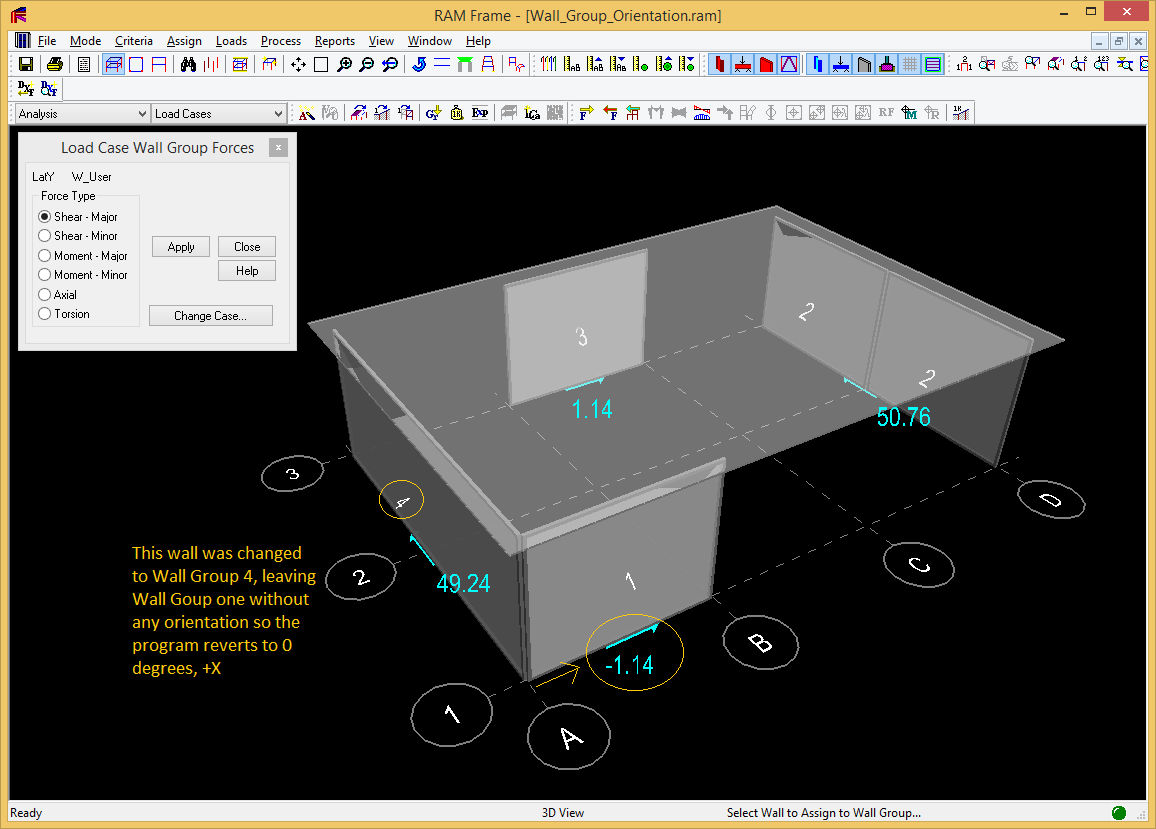

Confusion can occur when you start with a wall group like the one above, but then last "orienting element" for the wall group is changed to be in another group instead (walls can only be in one wall group). This leaves the original wall group without any user defined orientation, at which point the program reverts to default 0 degree (+X) orientation. This is apparent when wall group forces are reported or shown on screen as seen in the image below.
A Wall Group with no orientation reverts to the default positive global +X direction
To fix this, just re-assign one wall parallel to the desired orientation to be in the wall group again. You will need to rerun the analysis after assigning wall groups.
