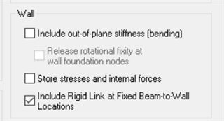

When modeling the lintel as a beam, the linear finite element of the beam connects to the corner nodes of the wall only. Consequently, the total stiffness of two walls coupled with a beam is less than the method above. There is an option within the Ram Frame - Criteria - General to control if the beam is virtually extended into the wall with a rigid link.
Using this option will result in a more rigidly fixed connection of the beam to the wall, and is not recommended for models with tilt-up walls using gaps. For further details refer to the program manual, RamFrameAnalysis.pdf, section 7.21.3 Moderately Deep Coupling Beams. Rigid links at beam to wall intersections are not recommended where the top of the wall is sloped.

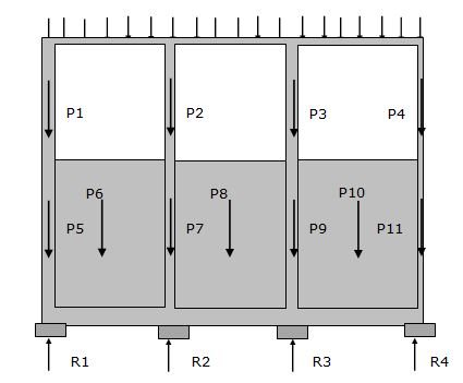

The presence of pilasters inside shear wall systems introduces a much different distribution of loads that has to be looked at closely.  In the Figure below, P1, P2, P3, P4, P5, P7, P9 and P11 represent the axial loads in the columns whereas P6, P8 and P10 represent axial loads in walls 1, 2 and 3 respectively. R1, R2, R3 and R4 are the external reactions.

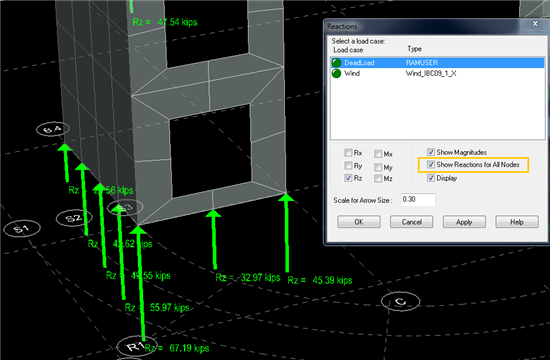

 Axial forces in Walls with Pilasters
A finite element analysis of the wall system shown in the figure above will give axial loads P5, P7, P9 and P11 which are much smaller than P1, P2, P3 and P4 respectively, because these loads are transferred not only to the columns also to the shear walls below.  In fact, the shear walls will often take most of the load leaving the column pilasters with very small internal forces. Many engineers want the pilasters to be designed for at least the loads that come directly from the columns above. There is no single tool to accomplish this in the program, so we recommend hand-checking that the pilaster below has at least the same size and area of reinforcement as the column above.
The frame reactions are the total reaction at a node. These reactions include the forces from the columns and the walls supported. For this system shown, the sum of R1-R4 is equal to the sum of column loads P1-P4, but forces will be distributed differently due to the presence of the walls.
It is worth noting that the walls themselves are further subdvided into a Finite Element mesh and if you prefer to view the individual nodal reactions, rather than the wall net reactions, use Process - Results - Reactions and toggle on the option to "Show Reactions at All Nodes"

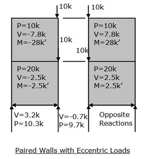

Shear and Moment in Walls due to Gravity Loads
There are many reasons why a lateral wall analyzed in Ram Frame (or any wall analyzed in Ram Concrete) may resist major axis in-plane shear forces and overturning moments from vertically applied gravity loads.
Asymmetric gravity load for example will cause an moment in an isolated 2D wall. Take the case of a single wall, 10’ wide with 2 levels of 10’ in height, but with no rigid diaphragm. At one corner, a vertical load of 10 kips is applied at each level. The resulting overturning moment is equal to 10k x 5’ eccentricity = 50k’ (per floor). Since there are no other elements connected to this free body (and since the wall element is not meshed in this hypothetical example), the reaction is entirely vertical at the right corner and the net shear at the base is zero.
The reactions in a meshed model will still be in equilibrium, but not entirely concentrated at the right corner. Horizontal reactions between the parts result as well as moments about the axis normal to the wall. Here's an example, using 2.5' mesh.
Next consider that same wall is connected to a rigid diaphragm which connects back to some other walls or lateral system. The presence of the diaphragm inhibits the lateral deformation and internal shear forces can now occur. The wall moments are reduced by this effect, but the shear forces can be significant. The forces and reactions in the opposing walls counteract each other, so there is still no net shear. Again note that when walls are meshed the relative corner reactions will change.
There are many other similar conditions that can occur in real-world structures that lead to these kinds of internal forces. A few of those conditions such as intersecting walls, column pilasters, and walls setting on beams are all discussed elsewhere in this wiki.

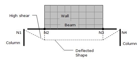

A frame wall is a shell element capable of spanning from support-to-support. If a frame wall on an upper level is supported by frame columns on a lower level, then that wall is able to span from column to column like a very deep beam. Consequently, if a beam is modeled on the lower level from column to column as well, that beam will not be directly loaded by the wall. Think of it like a small flange welded to the bottom of a very deep plate.
Bending forces in the beam still occur because the wall is meshed (based on the settings under Criteria - General) and bending deformation of the whole system is still possible. Axial tension under gravity load is expected, though a rigid diaphragm or stiff two-way slab would inhibit those forces as well.
To reiterate, the forces within a frame wall from the RAM Frame analysis are not delivered to the supporting beam in the form of an external line load. The only external loads shown on the Report - Gravity Loads are:
  1. member self weight
  2. line loads applied directly to the beam
  3. the loads applied to the deck supported by the beam
  4. reactions of gravity members supported by the beam
If the supporting beam is longer than the wall above, then the beam still acts like a flange but we can expect sudden increases in the shear and moment beyond the end of the wall.
Here the program creates additional nodes on the beam where the two finite elements are connected together and alone the length of the wall based on the mesh criteria. As the wall is vertically loaded, assuming everything is symmetric, the basic deformed shape of the beam will now look like a trapezoid (although the true deformed shape is actually a continuous curve and not “kinked”). Nodes N2 and N3 remain level and the same distance apart, thus there will be large shear forces and moments in the end segments of the beam, at the face of the wall. If the wall is broken up into smaller elements, then there will be additional nodes between N2 and N3. In this case, there can be relative displacement between the ends of the wall, but the deformed shape will still be basically the same when the wall is stiff in comparison to the beam.
Behavior of a Wall Supported by a Beam – Centered

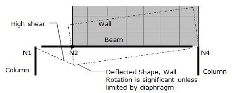

For situations where the wall is not centered upon the beam, or where the system is otherwise asymmetric, the situation is further complicated. Where the beam supports one end of the wall, significant vertical displacements can be expected, as opposed to the column support which is presumably much stiffer. A net rotation of the wall results throwing shear and overturning moments into that wall and the supported structure. When a rigid diaphragm is present, other frames may even experience lateral shear due to this rotation.
Behavior of a Wall Supported by a Beam - Off Center
If there is another level of framing or a rigid diaphragm at the top of the wall, that could limit the rotation and affect the forces throughout the whole system as well.
