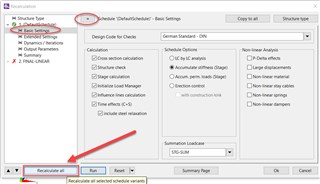

Recalc Window: 1. Basic Settings
In the RM Bridge Recalculation Window users can select the Basic Settings, including access to the button to Recalculate all, that will recalculate all selected schedule variants, as shown in the screenshot below. A right mouse click will change non-selected Scheule variants, shown with the red x, and turn them into a green tick to mark the selected ones.
Within the Basic Settings, the user will find the necessary adjustments for:
  1. Calculation
  2. Schedule Options
  3. Non-linear Analysis
RecalcAll
The Run button will work as the usual Recalculation that runs only the selected Schedule variant, shown at the side of the Recalculate Analyzer button at the Top Menu. Reset will allow for different options to set the recalculation options to the Restore previous settings for all or only this page to the program defaults. Ok will save the modifications and close the window while Cancel will close and not save them. More technical information can be found in the User Manual and in the Help Menu/ F1.
