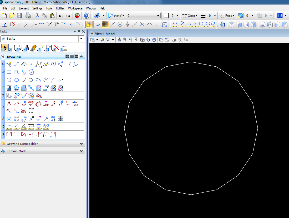

Problem Description
When a model of a sphere is attached as a reference (viewed as a circle) using a reference presentation other than Wireframe, and then saved to DWG with visible edges merged, the resulting DWG displays the circle with hexagon/jagged like or straight edges, see image 1.
Steps to Resolve
- Open the model in the DGN which has the sphere attached as a reference
- Go to File > Save As and change 'Save as type' to DWG
- Click on the Options button to open the Save As DWG/DXF Options dialog
- Select the References tab and turn on the option 'Merge Visible Edges of 3D Attachments'
- To the left of the tick box for 'Merge Visible Edges of 3D Attachments', there is an icon which opens the Visible Edge Settings (see image 2 attached showing this)
- The Visible Edge Settings dialog should open
- In the General Tab, change the Method to 'Exact' - this should help with the appearance of the circle
- Click OK, and OK again in the Save As DWG/DXF Options dialog
- Save the file and check if it has improved appearance of circle
Image 1
Image 2
