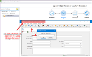

The procedure to save only the substructure model in OBD

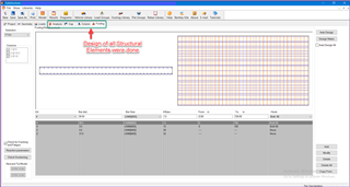

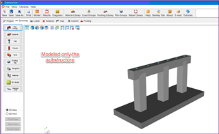

1) Model and Design only the substructure in Rcpier/Substructure module of LBC.

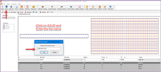

2) Then save the file and Enter the file name and then close the Substructure/Rcpier module.
3) The program saves all the information in the Temporary Path.
4) Then close and reopen the OBD program and click on LBC and in the substructure module the program will display all the inputted data/information and the design as well.
5) Do not save the file again under Leap Bridge Concrete as the program will lose all the information added in Substructure module.
