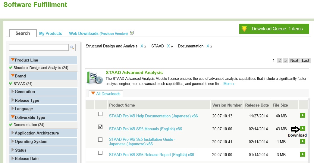

Log in to connect.bentley.com, scroll down the page and go to software downloads section and make the selections as shown below. Please make sure that you have enough privilege to download files; if not, please check with your IT administrator.

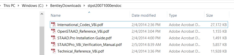

Once selected, check the box next to it and click on the download icon at shown here. The file 'stpst20071000endoc.exe' will be downloaded in your machine. Run the .exe file and the manuals will be downloaded in ..:\BentleyDownloads\stpst20071000endoc .
